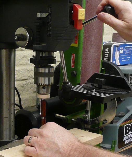

I turned a scrap piece of hardwood (ash) that's about 1 inch in diameter and turned a 3/8 inch diameter stem on it to place into the drill chuck. I use different pieces of scrap wood to bring the pen parts up to the correct height. Easier than adjusting the table location on my cheap drill press.

Same for me, but mine is Cocobolo.
