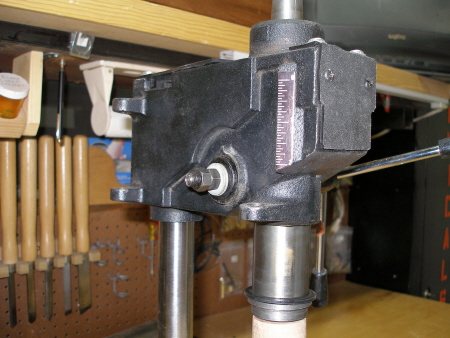

A while back I aquired an older Black and Decker benchtop drill press. I already have a benchtop DP, but I can't say no to a free tool. Sickness I guess. Anyway I decided to turn it into a pen press. I stripped it all the way down to the bare essentials. Took off the motor, pullies and the top cover. I think it will work very well for my needs.
My question now is, what kind of jigs or inserts to use to accually press the pens. I am hoping some of you out there have done the same thing. If anyone has and can post a pick or two or a link to somewhere with some ideas, that would be great.
If your interested, here are acouple of picks of what I have so far,

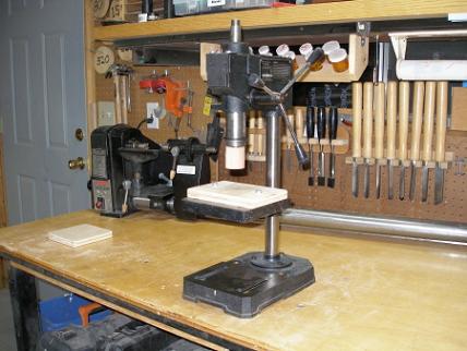

This is the press as it sits now,

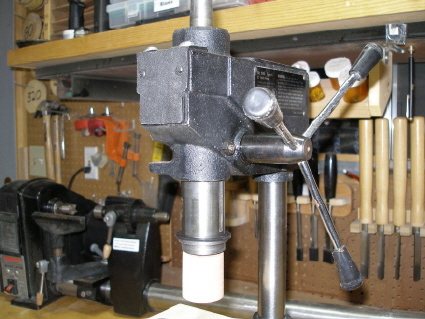

Notice I took the spring mechanism off, I did this so when I am preparing to press a pen, the top press mechinism will come "to me". That way, I will not have to take my hands off of the pen parts to reach for the handels. And the shaft pushes up easily with the back of the hand or an extra finger. I'll see how it works and make adjustments as need be.

I don't think you need anything else other maybe a few blocks or one that is like a stairs to accomodate various lengths/heights without adjusting the table.
Since acquiring my floor model DP, I use my benchtop Ryobi to press many of my pens. I use a series of scrap white oak blocks like Dario suggested. Works great and since I could only get about $60 for it, I decided to keep it so I can keep my PHD vise set up on the big DP. I also use the Ryobi with my sanding drums and other cutters. Hey, two DPs actually come in handy. As do two table saws and two lathes. Just wish SHMBO would let me get the Nova DVR that Charles is selling... or better yet, the Robust. Now THAT'S a lathe! Sorry, Steve, I got windy.[:I]
I know what you mean Billy, as soon as I win my Powermatic shop from Rockler, I'll have two of everthing. And if the SHMBO expects me to sell one set, well lets just hope it dose'nt have to come to that. Oh, I'm still waiting for my shop from Norm too.
BTW, If you go with the stairs type of shim...you can put back the spring mechanism. I believe it will work better with it [;)]
FIrst thing I would do is put everything back in it.
I would make a turret and off set it so a concentric circle would be directly under the quill. Glue in steps along the circumfrence , each one about a 1/2 taller than the last.
Use it in this configuration for milling blanks.
Turn a pice of hard maple with a tenon so you can chuck it up for "pressing"
As a pen press it is overkill.
Yes you can have the need for 2 drill presses, especially with kits that have two different sized tubes.
That is what I would have done.
I kept it simple. I use a piece of hard maple glued to the end of a 1/4 inch carrage bolt. I chuck it up and press with it. It can be quite fast with the right size shim blocks, step block. Just as long as the quill travel is long enough.
I like the idea of the concentric apperatus. I was thinking along that line myself. I also like the idea of a tenon mounted pressing apperatus in the quill. But it is going to stay a pen press. I have a systom for drilling blanks that I like and works well for me.
