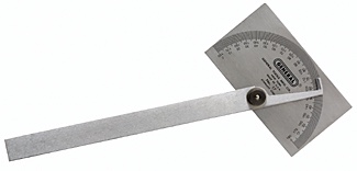

One of these. $10-$15
Machinist protractor.
