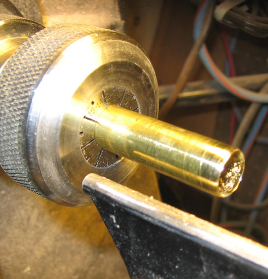

you can do lots of things -- like cut brass tubing while holding it in the collets
