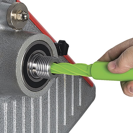

Kryn
these are good for cleaning out the the insides. That should help
it to seat better
