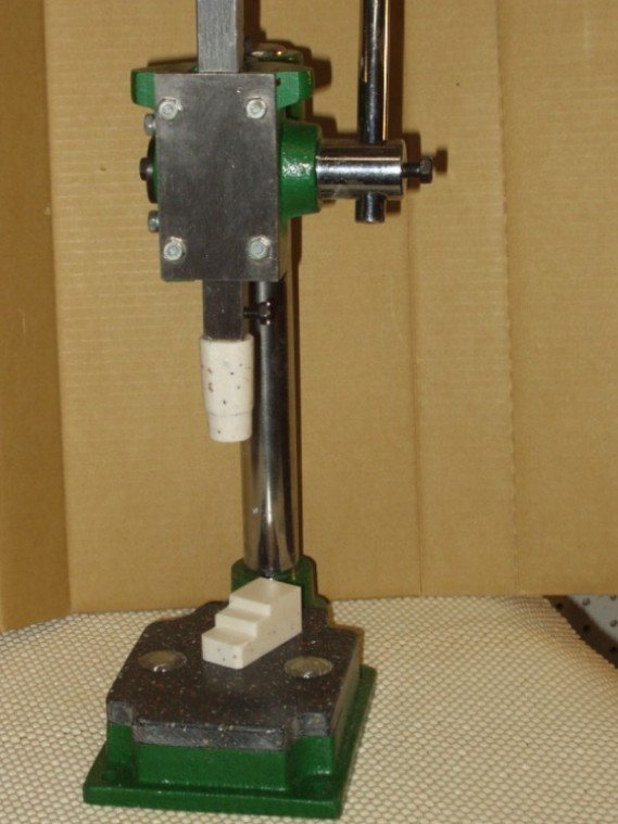

Scott,
This shows a step I made after seeing one also done for a Grizzly Press. Easy to make. Mine is Corian, Ram is bolt embedded in Corian.[8D]

I hate that I can't even figure out how to start making the plate and anvil and step thing. If anybody has a few spare minutes, could you drop me a line on how to do it? I have the press, but an stuck with all kinds of jury rigs to get it to work for me. BTW, I am NOT a woodworker...I just turn some pens. [8D]

PEN PRESS: I found that the best materials for making rams and steps for pen presses are UHMW and nylon. I believe Woodcraft sells a bag with assorted pieces. I got mine from:
www.machinistmaterials.com
This guy sells surplus metal and plastics. You can get a piece of either material for a few dollars, he is very reasonable. Either material will turn well in a wood lathe with wood tools.
I got the Grizzly press too, and I believe I was the original poster in another forum. Grizzly sold out of them very quickly.
