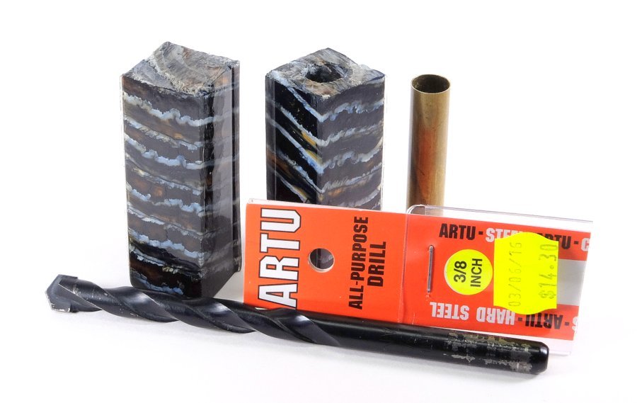

Artu Drills available in Metric and Imperial available around the world. I settled recently for just under and made the finished drill size in a normal steel drill in a Wooly Mammoth Tooth..
Peter.
