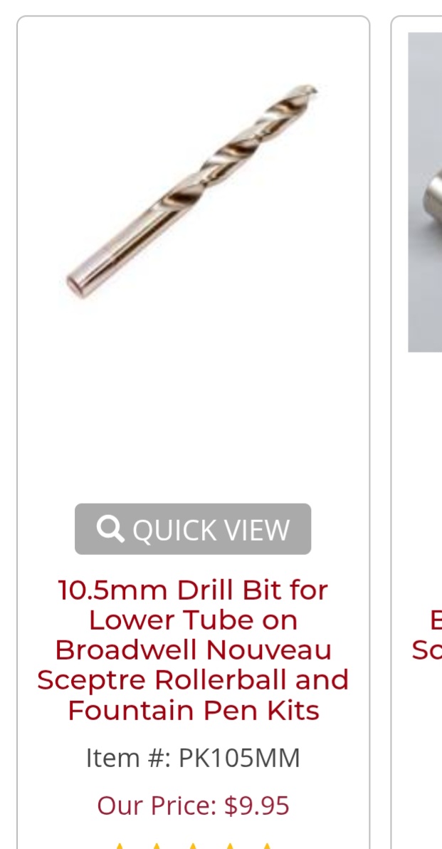

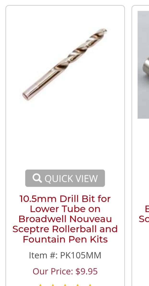

Is this the same kit?
The drill bit (DB) is the "commonly available drill bit size" not the best size. I often find the best fit is not the size on the instructions. I have a 115 DB and a Metric set as well as some "odd-ball" sizes like 12.3mm
