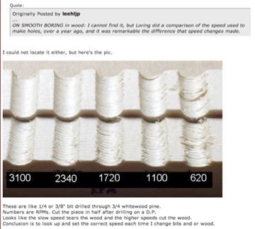

Below is a pict that a friend did on a woodworking forum. Of course it is made in soft wood (pine) and hard wood is different. However, speed differences, feed rates, sharpness play a huge role in the outcome. Faster speed and a so-so sharp bit will be smooth but the slower one goes, the sharper the bit better be, or the more catches and tear out that occur. As noted above though, the faster one goes, the more heat is built up, which can cause cracks. Slower causes catches, both cause blowouts.

The numbers are the RPM speed. Done by one of the resident "engineers".
The above picture is Not intended to be definitive on the subject at all, but show that there IS a correlation on speed and smoothness in some situations.
