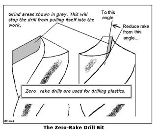

Another trick for drilling plastic, is to shape the bit differently.
After it has been sharpened, you can grind an angle on the cutting faces. Sorry for being vague on that, but I'm sure you could google instructions on how to grind it. I have seen this angle already ground into the pilot bits of several holesaws.
A bit long winded, sorry. But the point I was trying to make is that you want to 'drill' the hole and not 'screw' the bit through the soft material.
Of course, there are hundreds of ways of doing something. But this works for me.[
Just found a picture that shows the angle to grind[
