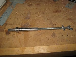

I don't think of a drawbolt as being a designer tool so it doesn't really need to be very fancy so your comments about the one you made puzzles me a bit. Maybe you could post a picture of the one you made so we can better understand why you are unhappy with it and get a better idea of what you are looking for.

here you go
