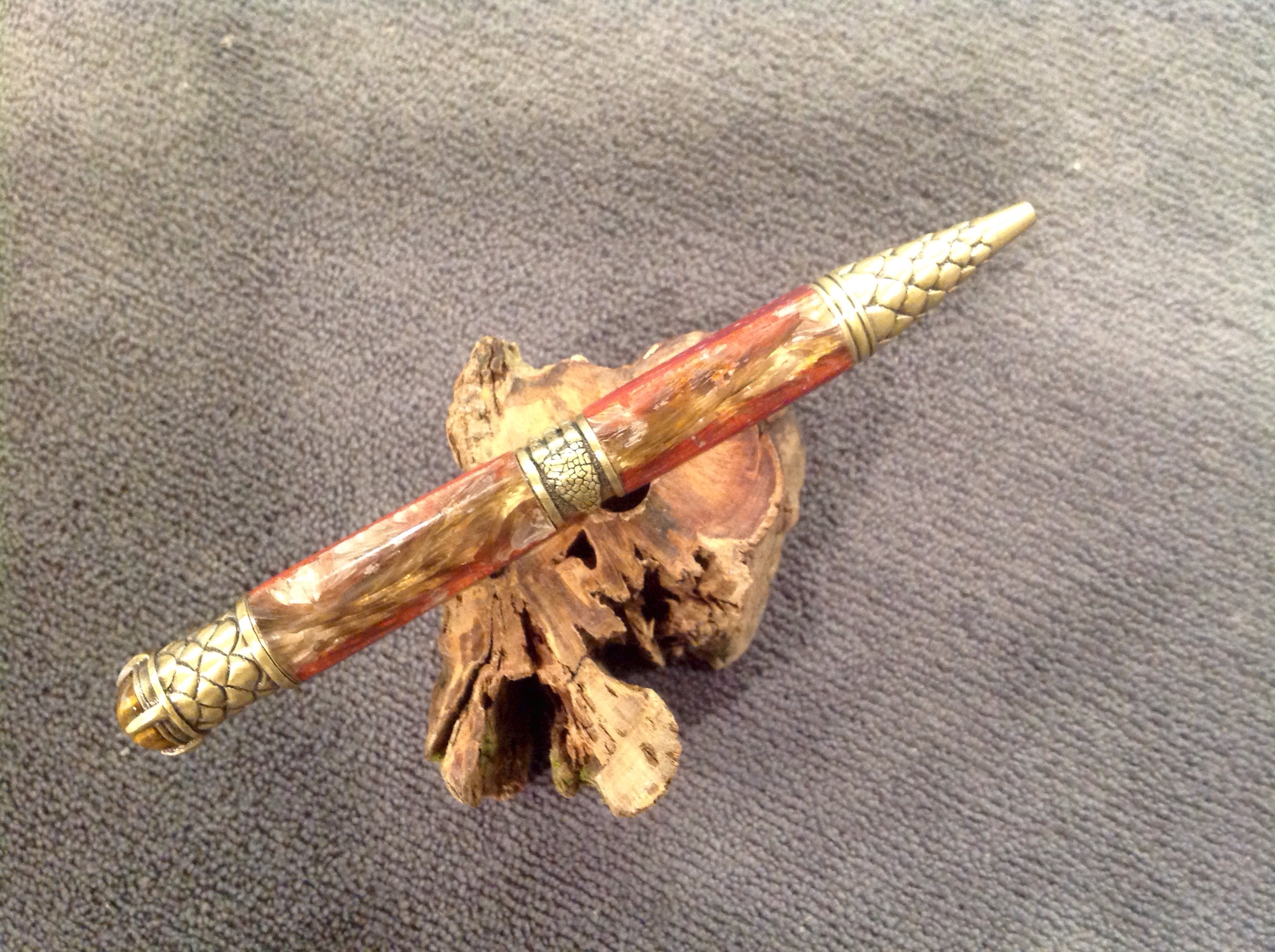

Dragon
See more from Gus Jr
Looks good. Be careful with it, they seem to be weak at the coupler.
Yes, mine broke there too easily....thread metal very thin on that coupler. Very disappointing.... PSI did replace it though :)
Did you inspect the new part and if so did it seem sturdier or the same?
