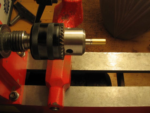

I just put together 10 euro round top double twist pens and one pen and pencil set and I did not glue the second set of tubes. I noticed that to ensure smooth operation for the pen, the cap assembly must be able to rotate smoothly around the brass area of the transmission. Unfortunately, when you press the centerband on the cap, it will shrink the diameter just a hair and cause it to bind on that brass area. You can either try to ream out the cap tube to increase its I.D. or, what I did was decrease the O.D. of the transmission. I mounted my MT2 drill chuck on the headstock which held the transmission finger tight. Using 240 sandpaper, I just sanded the brass area briefly, until the cap will slip on and off.
