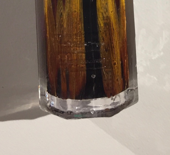

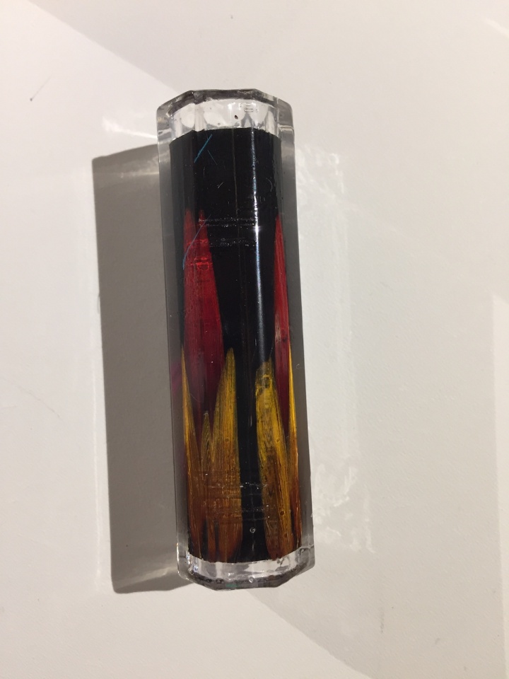

this happens .... :mad: So frustrating.

Not sure what you are refering to. If it the bubble I bet it may not be deep enough to make a difference.
Unfortunately the bubble is sitting right on the feathers so there's no salvaging this blank.

It goes under the clip and it is all gone:biggrin::biggrin: I know you sell your blanks and this one may not be able to be sold but I would do some experimenting with it to try to correct it. Spin it to size and drill out the bubble and clean it and do a CA fill.

If this is a Sierra blank, I would clip off the end and use it on a toothpick keychain kit. Toothpicks may not fit anymore but it will make for a salvaged blank and a finished item!

I was making blanks with polyester resin and printed graphics with the same experience. I don't use a pressure pot and found that the tiny bubbles happened more in cooler weather when the resin runs thicker and takes longer to harden. Worked well in summer months which temps in upper 70+.
Today it's -5C but I'm in a heated garage and I warm up the resin to make it more fluid and cast under pressure. I think I have all my bases covered .... :question:
