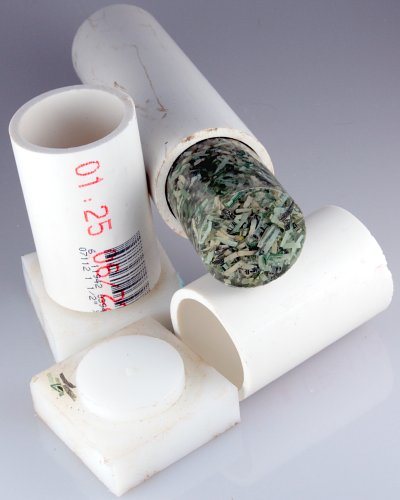

I cast under pressure, using pvc pipe for molds.
I turned tenons on blocks of delrin such that they jam-fit into a 1 1/2" pvc pipe. It's tough to see, but I left a small spike in the center which gives the casting a dimple in the center for a drill guide.
I jam the pipe onto the base, fill it with polyester resin, and let it cure in the pressure pot. Once it has set, I pop the base off, and push the casting out with a piece of broom-handle. I have mold-release agent, but have not used it.
I don't doubt that silicone molds would be nicer, but I'm satisfied with the pvc/delrin ones.
