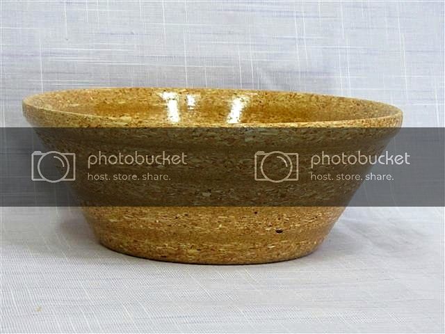

Don't try MDF on a lathe unless you are very confident about it because it is not usually a very stable product and if you do use slow speeds .
With that said, when I made this little video two days ago
Easy Segmenting Jig - YouTube
to help some out on the Segmentation Frustration thread that a member started , I mentioned (I think a couple times) that it was just MDF for demonstration purposes and I would be throwing it out.
Well after that , I got one of those "WHAT IF" moments and wondered what kind of a bowl it would make . I didn't have a suit of armor to put on but I did use a hat and a full face shield and even a coat on top of a long sleeve shirt just in case . . . .
All went well and I applied the finish on it this morning .
When cutting it and sanding it the texture seemed a lot coarser than most MDF I have used for jigs and such and it was not until I was all finished that I realized it was a much lower grade of MDF . Maybe not MDF at all but carries a different name ? I compared it with MDF that I am more familiar with which is more solid as shown on the left. The bowl was made from the kind on the right . I have seen that kind use in packing crates and such and probably costs less and is not as strong so I was glad it turned out alright.
I'm guessing you had a few moments while turning where you were thinking...."When is this going to come apart?"
Fantastic results!!!
Scott (nice glossy finish too) B
I have to admit I was a little nervous and was well prepared and made sure to stand off to one side while turning it .
looks more like particle board or underlayment but it turned out beautiful. Very nice Job.
Particle board was my thought also. Nevertheless it made a great looking bowl.
Thank you for suggesting what that type of board is. I believe you are right that it is called particle board as opposed to MDF on the left side of the picture. .
Yep, it looks like the particle board cheap shelves are made from to me. You had a mighty good success getting it made without issue. Good work!
That looks awesome!
What type of finish is that? Looks very glossy for such a coarse material!!
Phil
Phil , It is just rattle can lacquer but normally with real wood I only need one coat of sanding sealer whereas that stuff sucked in the first coat so I gave it a second one . Then four coats of lacquer on top of that .
It came out great.

It is hard to tell in the picture that it is the same segmented board that I showed in the video . My joints were so tight that I could hardly see them at all when trying to stagger the joints when stacking the rings . I had to guess at most of them and I know some are not properly staggered ..
That's a great looking finish, wouldn't of guessed rattle cans!
Do you cut back the finish and then buff? Or just straight from the can?!

Not sure what you mean about cutting back the finish when using rattle can . It is straight from the can and no buffing was used .
Rattle can finish does take practice to get it looking close enough to a HVLP gun sprayed finish . I only use it when I have one or very few to do . I prefer to wait until I have a bunch and set up my HVLP conversion gun to spray them .
Just meant do you sand back the finish to smooth it out, then polish. But obviously you're just good straight from the can!!
HVLP sounds interesting, been looking at a few finishes for bowls etc and looks like that's the way to go. Do you use a polyurethane finish through the HVLP?! Thanks for all the answers!!

I only sand with 320 after the sanding sealer . No sanding between coats with most lacquers
I use a very high quality WB lacquer when spraying with HVLP
