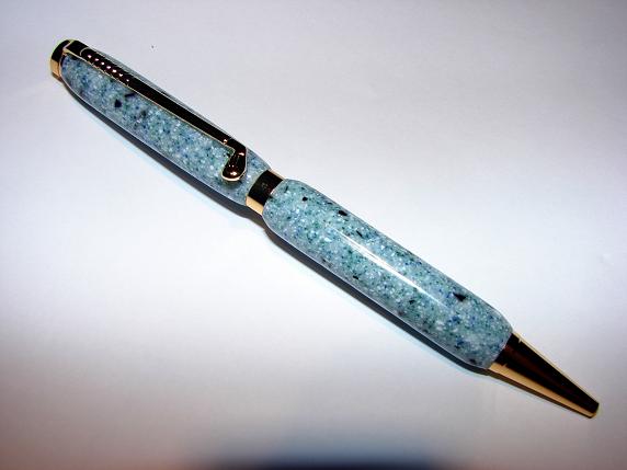

As a New Turner of Pens, I have learned a lot from mistakes. Attached is a picture of my first Pen with a special clip. It was make from Corian and turned very well. When I got through pressing the pen together I noticed there was and small indention on the tip from where I pressed it in the pen press. I learned that it is best to put the tip toward the other end of the pen press rather than the nylon side where the small hole is. Can't really see it in the picture. Otherwise I think the pen turned out nicely. I gave it to brother in law and he never noticed. So keep it quite.

Attached is a slim line not a cigar. On cigard you can unscrew the nib before you press it together to avoid getting a warp in the nib. (DAMHIKT)
Great Job on the pen. I have made many pens from corian and one of my biggest mistakes was too much pressure. Corian does not like to be stressed, it can crack when you are putting the pen parts together. PM me if you have any questions.
My first pen had a golf clip just like yours. The kit was a gift from my penturning friend.
Are you saying that the nylon block on the pen press dented the nib/tip? I would assume it happened when installing the twist mechanism. I can't see any dent but I'll take your word that one is there.
I think what he means is that the nib was in the hole in the nylon block, and when he pressed the pen together, It left an indention around the nib about 1/8" above the very tip of the nib.
My press came with the same nylon block with a hole in the center, and a metal block on the other end. I turned a wooden "Sleeve" to fit over the metal block. No problems since.
Yes I was talking about the small hole in the nylon block and it happened when installing the tip on he pen blank. I to have also turned the pen tip or NIB around towards the other way. As far as not seeing it in the picture, it is hard to see it in person but I know it is there.
