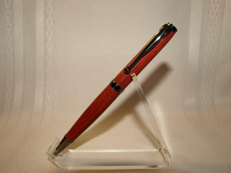

i did make a pen using shellawax and it turned out great. Take a look! it does shine like glass. The picture doesnt do it justice
Jacob,
The pen does look great. Looks like bloodwood to me.
Having said that, the question is "Does Shellawax last?"
You have a new pen; it ought to shine.
I'd be interested to here you report back how it shines after 30-60-90 days of handling.
