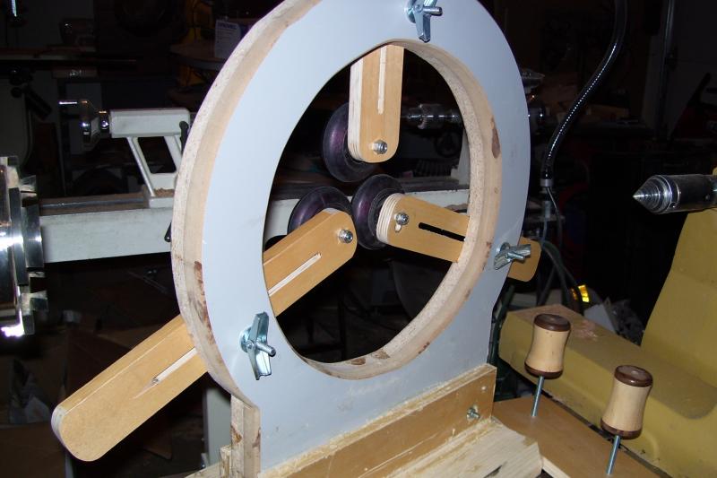

I've seen a few homemade steady rests using rollerblade wheels. Have any of you made a steady rest? I'd like to hear your experiences and see pics and even tutorials if you have them. I'm thinking of making one for doing tall pepper mills and other longer spindle work... pros/cons? Is it worth making or should I just buy one?

Honestly, I love to make things on my own. I don't mind making jigs and tools instead of turning. I also like to NOT spend alot of money. But if my mdf steady rest will not hold up as well as a cast iron or aluminum commercial version, I don't want to waste my time.

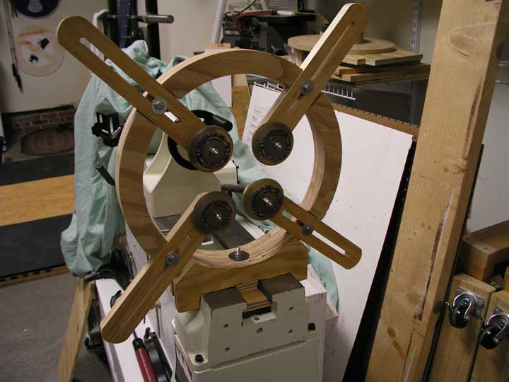

I made my own and it has come in handy. I went to Play It Again Sports and bought the best pair of old in line skate they had, which cost me $25 and gave me 8 wheels with all 16 bearings, two per wheel. I cheated and had the ShopBot operator at work cut my rings out of 3/4 plywood for me, not very good at cutting them with a jig saw. I have a Jet 1642 so my outside diameter was 16" and the rings are 1.5" thick. This centered the ring on my spindle. Not a difficult project, found a couple good pics on the net and went for it. Used wing nuts on the back side of the arms. I need to replace the washers on the either side of the wheels as they are too big and had to loosen the nuts so the bearings were being used.

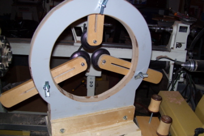

I made this out of scrap to see if it would work. Worked so well I still use it. Wheels are from Salvation Army Thrift Shop. I routed dadoes for the arms. They're attached with 1/4 inch flat head bolts and wing nuts. Works great on my Powermatic 4224. Can also be used for smaller diameter stock.
