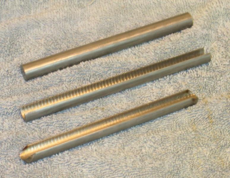

I use a Wolverine Jig to sharpen my gouges, but don't tend to fool with it to try out new profiles because I don't want to go through expensive gouges trying to find new profiles. It was with this in mind that it suddenly occured to me that I should try and make my own gouges! I could then experiment with them to my hearts content on the Wolverine Jig and once I have a new profile that I really like, I can re-profile my Thompson tools.
I decided to make several short double ended gouges that would be models to experiment with before making one to turn with.
At $0.75 in raw materials at 6" long, I don't mind grinding them to oblivion.

That is sort of the idea I had in mind. I am going to make a set of these mini double ended gouges with various profiles on them. I'll stamp info into the tool to let me re-create them. I can also put these tool bits in my Hosaluk handle and try them out as I started with 1/2" stock. I just have to experiment to see if I need to harden them, or if I can just take a few cuts with them in their current state.
I made them last night, and have not had a chance to try them out yet on some light spindle work to start, then maybe a small bowl.
