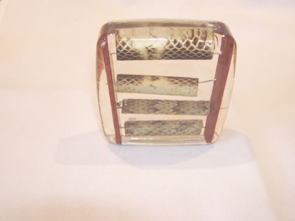

Did you use your pressure pot ?? Looks like it, that cast is crystal clear [:)] How about the recepie, did you go to 10 drops ? Looks great.
Thanks Anthony. I will never do 10 drops again. Everything melted but the tubes. I used 6 drops (droping back to 5 next time) and yes, this was cast in the pressure pot at 60 psi. It really is clear; I was very happy with the results . I took it to bubbasville last nite and no one could find any bubbles. It worked great. This was my first time to pressure cast. The blanks were for a baron and cigar. I gave the barron tubes to Ron McIntire and I ruined one of the cigar blanks due to my stupidity, which seems to be running rampant lately. Got the pressure pot (for paint) from HF for $79...it is a 2 1/2 gallon pot and I made a shelf for it and have two layers of shelfs to put the molds on. I can get 8 molds(maybe more) in at once, except I only have 3 at the present. More experimenting today. Chow!

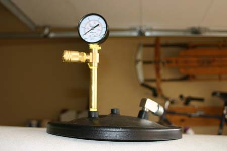

<br /> Got the pressure pot (for paint) from HF for $79...it is a 2 1/2 gallon pot and I made a shelf for it and have two layers of shelfs to put the molds on.

Your casting looks great. Perfectly clear! Are you bringing the pot to 60 psi and then sealing it off with a valve, or leaving it hooked to the compressor? Pressure for entire cure time? As you lower your drops per ounce of catalyst, are you experiencing "sticky" or "tacky" castings? The first set I did are sticky on the exterior but seem to turn ok. Again, nice job!
I pressure it to 60 psi and remove the air hose so I can still use the air for other stuff. The resin cures or sets in an hour our so. I just leave the pot pressurized the entire time. Mind you, this is my first casting under prressure but will not be the last. Every PR casting I have done has always been stickey on the surface exposed to the air...just that one side. The surfaces touching the mold are totally non-stickey. Don't know why...that's the way it has been.Thanks for looking and comments. I normally use 7 drops per ounce but am reducing that. I am now to 5 per ounce and my next cast will be 4 per ounce. Anthony Turchetta in a post earlier in this thread mentioned 10 drops in 4 ounces. I am working towards that and comparing the turnability of the cast. More later.

Don,
I tried looking through HF for a paint pot, but didn't find one. Still searching...
Never mind. Of course, just after I post this, I find this...
http://www.harborfreight.com/cpi/ctaf/Displayitem.taf?itemnumber=93119
and this
http://www.harborfreight.com/cpi/ctaf/Displayitem.taf?itemnumber=37515
The later seems the better choice (and looks an aweful lot like yours Don!).
I don't know what the difference is. There is a pick-up tube screwed into the under side of the top aht goes all the way to the bottom to suck up the paint. The pick up tube needs to be reomved and the hold on the top plugged. All threads are 1/4 NPT so fittings are found at any place that sells pipe fittings. I did not use the regulator and scuh that came with the pot. I could not keep it fropm leaking. I just used a brass pipe nipple, a tee, an air hose fitting and the guage. Plug in the air hose, watch the guage and remove it at 55-60. I left the resin in the tank all night because I cast it late, but it cures quickly and could probably be removed after and hour or two. The bubbles are crushed in size and rendered invisible. I think if the pressure were released too soon...while the resin is in the jell stage...the bubbles would expand and our efforts to eliminate them would be worthless. The pressure needs to be left on until the resing is totally cured. Just my thoughts. I'm doing a second cast tomorrow.

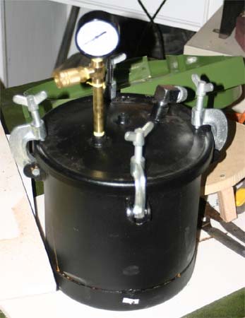

Pressure casting working really good, I did mine in a pressure cooker and tested to 50 PSI but will not go futher to dangerous, Don pot in the way to go and it go up to 70 psi I think, here's the photo of my pot and my casting
edit == Pot photo deleted

To return to the original question ask by GaWoodworker casting natural snake skin is not a problem the problem when is dey you may have problem like I encounter when I cast leather fish skin and cane toad skin is about the chermical they use to tanner the skin, my casting was a total FIASCO PR when into the leater in pressure and I find myself with brass tube [:D][:(][xx(] will give another go
Conclusion no bubble at all for pressurised PR, is crystal clear when you turn filaments are a little bit longer than corian ( remember corian is cast under pressure too ) here's my pen " Australian sea snake skin "

After a visit from Don a few days ago (on his way to Bubbasville), He told me about the Pressure-pot. I couldn't get to Harbor Freight fast enough and bought the same pot that someone here showed from HF.
Once I got the inner suction "tube" removed and sealed off and also the "out" side of the pressure gauge, I was ready to go.

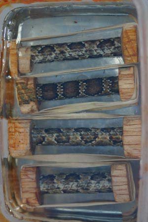

I thought a bit about what the process was to be, according to Don's early experiments and decided to go about it a little differently. I decided that once the mold had reached the "gel" stage, that probably nothing more, change-wise would occur. that is, there would probably be no more "compression" of the bubbles by that time.
Sitting out,(normal curing method), the gel generally takes place within 10 to 15 minutes, so I decided to apply the 60 pounds pressure for only an hour (just to be safe). After an hour, I released the pressure and removed the mold. It was PERFECT - bubble-free and clear.
The next mold was left in for 40-minutes. Same result. I've only done two thus far, but my next casting will be left for 30-minutes and if that works, I'll go down to 15-minutes. Like I originally thought, once the pour has gelled, where is anything going?
By-the-way, (and I think Don already pointed this out), the top surface of your casting WILL ALWAYS BE STICKEY, REGARDLESS OF HOW LONG IT IS CURED. Just disregard this fact and go ahead and saw up your blanks after the blank has at least cured overnight - if the other surfaces are rock hard, you're ready to go.
And Texas John - "How many blanks can you make with a snake skin?"(or something like that). Well TJ, how long is a rope? Don't take me wrong, but no-one can answer that question. But this will give you some idea.
I make only pens made on the slimline "chassis" The tubes are 7mm in diameter. This takes approx a 1" x 2" rectangle of snakeskin to wrap around the tubes (yes, most use CA to glue them down") This is just a point of reference, but just measure the diameter of your tubes and the length - then make a rectangle, using these measurements to determine the size of your snakeskin piece to be glued down - also, allow a 16" or so oversizing to allow for the "fold-over" necessary to hide the seam. Hope that helps.
