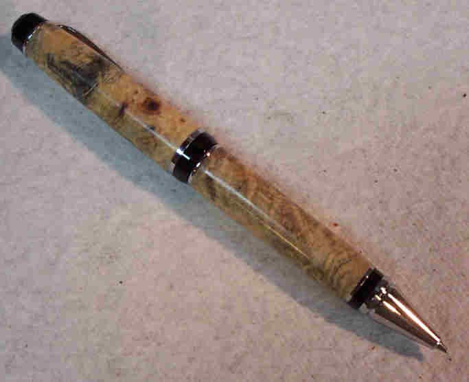

Here is a photo of the pen. For Posterity
<br />
I thought I did a nice job on the pen. A cigar in stabilized Box Elder Burl. All was well until i assembled the pen an realized that I mixed up the blanks. I used the short blank for the bottom! DOH![:o)]
If you'll notice, the pen is closed.!?!
That what I get for turning an listening to the Sabres on the radio at the same time!

I think I will. I not only assempled the pen incorrectly. I got the part mixed up on the lather. That's were the problem started. I will have to return the lower tube and come up with an intersting way to "fix" the upper.
Any suggestions? This is my second cigar, and I am design challenged. [:D]
I'm thinging maybe a small band of blackwood. tapered to meet with the undersized tube.
But how will that look with the box elder?
