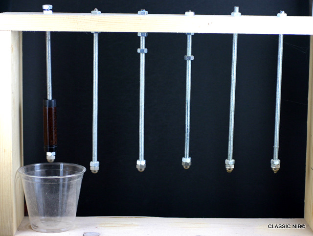

Lacquer dipping stand
Here is a dipping stand that I use, I use derlin bushings made for each pen that I make on both bottom and top. Let the lacquer drip into the cup. When dry reverse the blank and dip again. I give between 8 and 10 coats. Let cure for 2 weeks and buff. The stand can do 6 blanks.Hope this helps.
BTW, I stole this idea from someone here, not sure but it could have been Butch.
