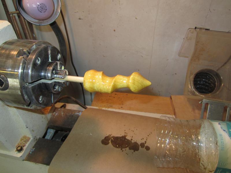

With the success of my pen dipping/squeegee method I need a way to do my bottle stoppers.
So I went with centrifugal force! Worked great!
Just used a water bottle with the bottom cut off to catch the splatter.

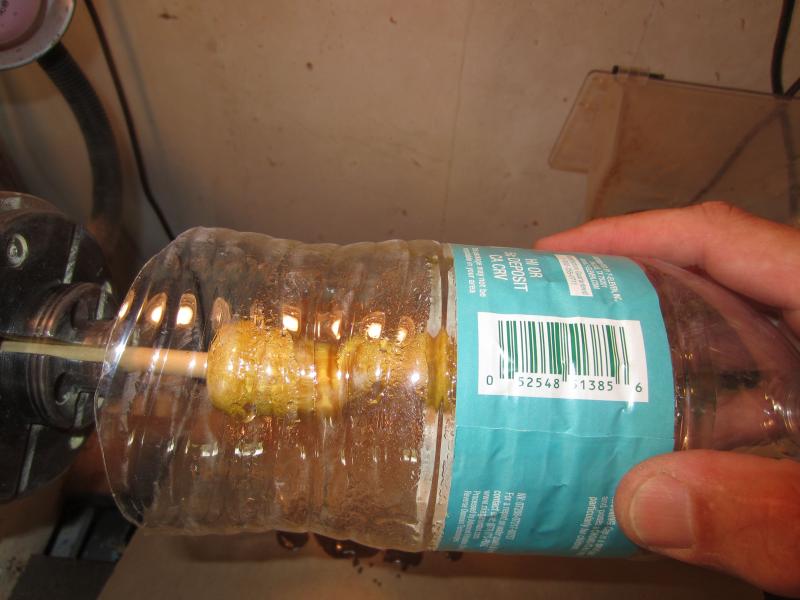

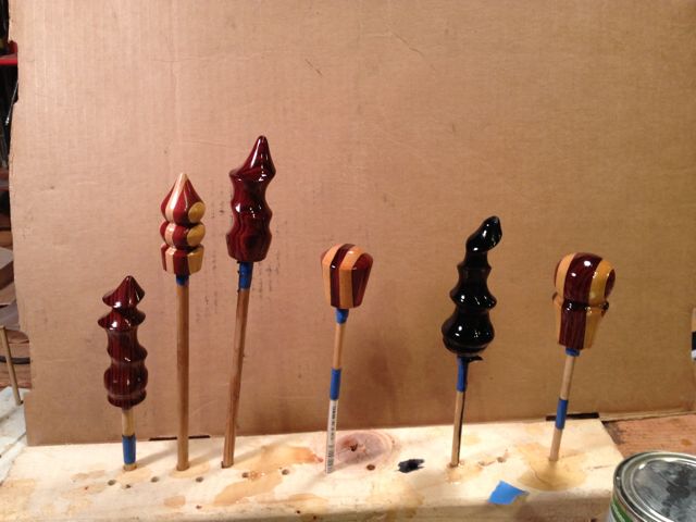

OK. Here is a little more detail.
I used same dipping solution I used for the pen (via Pen State).
With the stopper mounted on a dowel and dunk the entire stopper into the can of dipping lacquer. I let the bulk of the solution drip off back into the can. Then I mount in on my lathe with a cut open water bottle around it (as pictured) and start the lathe. The centrifugal force removes all the excess lacquer, the bottle keeps the splatter contained. I the let it dry over night.
