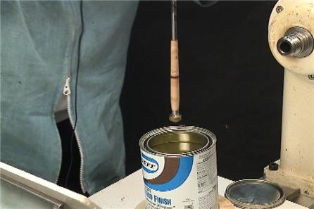

The attached photo shows dipping with an old 7mm ,andrel to hold the barrels. Note the bushing at the bottom, and the smooth transition between the barrels. Since the top is "open" there is no need for anything there.
This isn't a good photo because it is a frame that was grabbed from a video presentation of "dipping".
