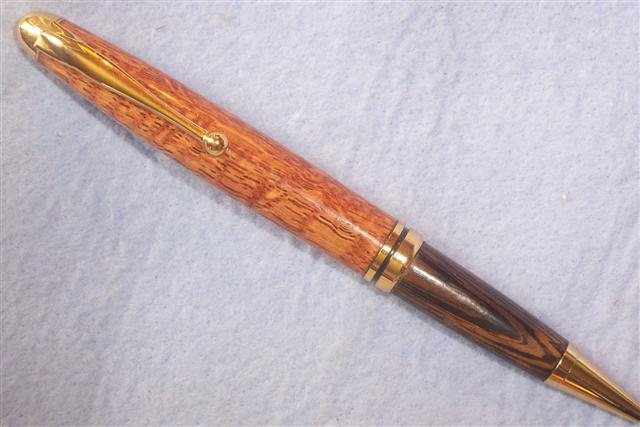

First I'd like thank everyone who made comments ,suggestions and to Grizz especially for doing the Photo work that is beyond me.I had already modified the pen based on some of the suggestions that were made in the previous thread/post.
Rather than reply in the original thread I decided to start a new one as the intention of this post is to focus on the concept of modification rather than appearance.( woods, shape,finish,clip and in a small way CB.)
Comments/criticisms are still welcomed and appreciated.(sometimes adopted or adapted depending which key I hit):D)
Simple pens or is it Dr.Phil?-In other words, What were you thinking?My immediate reaction when I finished turning the original pen was "look at the grain!"I wanted to show as much as possible and since the design was mine I did.That is the reason for the smaller clip and the "barrel shaped top".In retrospect, like a magician I erroniously diverted your attention away from what I wanted you to see.
Tom-I would have rather used the Perfect fit for the modification but there were issues I was uncomfortable with.They are not insurrmountable but I worked with what I had on hand. The Perfect fit tops' transmission engages in the bottom of the "cap holder finial" much like the American classic but more forgiving.The tube in the P.F. is shorter than the one in the components I used and does not support the lower section of the top barrel. If you look at the instructions on the SL longwood the tube on the top extends over the transmission which is the same as the PK MON PAR.This gives the pen rigidity that you won't have with the PF.I could have used the clip only but that would have meant scavenging a clip, finial and stud from $7.00 "kit" to make a pen that I was using to keep economical in the first place.(I don't know why custom clips are not available for pens te size of a PF, American Classic but they are not.In lots of 10 the PKMONPAR is $3.30. from Woodturningz.I think that is a great price for a pen that utilizes a Parker refill and can accept a gel refill.
I used the gold CB for reasons of strutural integrity also.The other reason for the gold band is I wanted to make the pen with all supplied components changing only one piece and to show how easily the over all look of the pen can be transformed.
My choice of woods is inconsequential as it is a matter of personal choice.Since I was confident in my idea I just "went for it" and used one of the nicest blanks I had rather than experiment with a lesser quality wood, or manmade material.I chose the Wenge for the same reason. I used an exotic hardwood for the top and I thought the same quality should be on the bottom.The alfthzilya(whatever!)x-y lay was given to me by Lou months ago and it is not in my "general stash".
I could have used "blackwood" or ebony but I believe I have a tendency to use it too often and want to try something dark but not necessarily a solid wood.I can always make a new lower section as this modification is repeatble.
Chuck- the dimensions of the lower piece are not important as to the length.The tube is 2&3/8ths for the Parker refill on this pen(I think)The one thing you need to keep in mind is whatever you take off the bottom needs to be replaced at the top.Until you reach the point that the transmission hits the finial holder.There you can take up the slack by adding a CB but it will not have a tube in it unless you waste a PF tube. They are perfect to fit over an 8mm tube but I believe they are proprietary to the "B" company.If I run across a tube that will have the same fit at a hobby store I will use it.
One more word about the CB.The top tube does not extend all the way to the bottom of the top blank.There needs to be clearance so the transmission holder and transmission can make contact with the 8mm tube in the top of the pen to extend the refill.
There is a clearance issue that needs to be dealt with also.When gluing in the top tube it is inserted from the top down.There was glue reside that needed to be removed so the transmission worked smoothly.

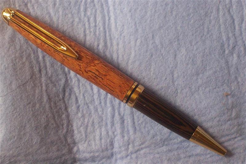

There you have it, with changes made as suggested pertaining to the shape of the upper section.
(My point in doing this is if I can make a "longwood" pen with a Parker refill why can't the manufacterers supply one to give us another style to offer customers? On second thought I'll just use my $3.30 "kit" for now)
Also why is there not a "Parker Style Kit" that is as easily modifyable and customizeable as a slimline?Why Can't I get custom clips for an 8mm pen barrel other than Euro style?(bigger dia)

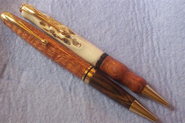

For comparison,
A "longantler from a $2.00 slimline using a Cross refill along side an"Eaglaized"eurostyle longwood from a $3.30 "kit" that takes Parker refill.( interesting what a $1.30 will do) plus the cost of the smaller clip.

Eagle, the slimmer upper barrel and straighter lower barrel make a big big difference in the pen.. it now looks more elegant instead of "clunky", if you will excuse the term... it is a shame that you can't find a better clip and centerband to really make this a truly elegant pen...
Nice re-modification of the original modification... HUH!!. does that make sense..[:p][:p]
Eagle, that looks much better. How does it feel? It looks like there would be a lot of weight in the upper half of the pen, which might make the balance a little "off", but it is hard to get a good size perspecitve from the picture. I also don't know how dense Afzylia Xylay (or however you spell it) is, especially in comparison to something like Wenge. The reason I mention this is that by using a more dense wood near the tip and a less dense wood (e.g., something spalted) at the top, you might be able to further impact the balance.
Just the rambling thoughts of a humble novice. (alright, maybe not so humbe, but still very much a novice!)
Fantastic job Eagle! I love the way your hands tell us what your mind is thinking. I love to see your designs on pen kits that I do according to the instructions. I think you have a true gift or art for pushing the envelope and coming up with a beautiful work of art.
Way cool. Much better aesthetically. I think I understand how the transmission slides up into the upper barrel (upper tube short / lower barrel short with longer tube, correct?). I'll have to checkout a PKMONT-PAR kit at home tonight to understand fully. I thought the coupling (that the transmission screws into) had a ring the same diameter as the bushing size.
Nice out of the box design. I like the option of having alternate style Designer mods.
Thanks for the " how to do it explanation " the re-modelling look much better and I like the concept, you should patent the idea and sell to CSUSA or PSI and live on ROYALTY[:D], Bravo.

I still like it, Eagle, but I have to admit that it does look better with the upper barrel narrowed a bit. And I think I understand now! [:D] But we'll have to wait until I get home to find out. [;)]
Eagle.
I want to chime in here. This is a case where simpler is better. This straighter, unadorned version just comes across so much better. I am very impressed with this pen! Thanks for showing it!
Scott.
Eagle, after comparing the before and after post. I really like the modifications and feel that the look flows a lot better. Your choice of woods really works for me. Very impressive. Thank you for trying new ideas on routine kits. It sure opens up the limits for the rest of us.

Ok, now I am confused. Several people seem to be seeing the pen as being different in the second picture. I can't see any difference, other than a slight change in perspective. Am I missing something?[?]
Tim, compare the images here with the one in this thread to see the differences folks are referring to...

Eagle, care to send it to me for a "long-term test drive"? [:D]
The PKMONTPAR is 5-3/8" long or about 1/4" longer than a standard slimline. If the "v" between your thumb and index finger hits near the center of a slimline, it won't be noticeably different on this pen. The balance point on this and most other kits is just slightly nib-side of center, allowing the pen to gently rest on the paper (until us heavy-pawed Americans jam the point into the paper). This will vary a bit based on the cut of the barrels as well as the weight of the material used for the barrels.
