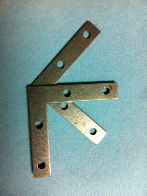

I saw this in a magazine the other day. Two corner brackets glued with CA. Works like a charm. Cost? Priceless. I had a whole box of the corner braces just laying around.
