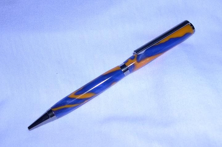

Couldn't get the right kit at Woodcraft, so it's not assembled yet. Will put one up when it's done.
OK, got a kit, so here it is...
I'm pretty happy with it...

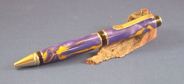

Cool looking pen Rich. I am more a wood affectionado but have many clients that prefer the acrylics. LOML prefers the classy looking acrylics for herself also. I have a co worker from Florida and asked me to find his some gator colors. I picked this up from Ernie at btw. Saw yours and had to show mine er... his.
Pretty cool lookin stuff. Glad he liked it but Im still trying to get some TEXAS orange.
