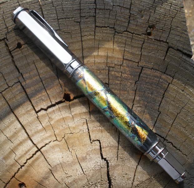

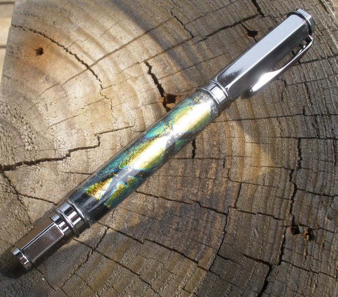

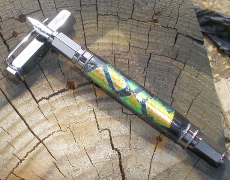

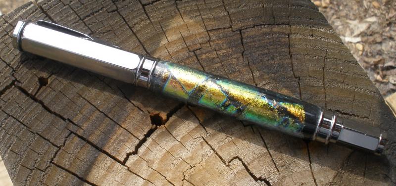

As I've mentioned before, Dawn and I have been bouncing ideas off each other in an attempt to make a more turner friendly version of her Dichroic glass blanks. We, this is the first semi-successful version. I need to do a bit more work on the process, but it is definite progress.
Once I've got a few more kinks worked out, these will be able to be turned on ANY kit without fear of hitting a piece of glass and shattering it.
The Still Picture Shy Dichroic V2.1
The were just quick shots to try to get a feel for it. The first five shots were moving around the pen without touching it, so you can see some of the color change as the light reflects and refracts in different direction.

Mike, what are you forming over?? Stainless rod, or did you shape a piece of kiln furnture? I've thought so hard on it and my wife has been after me for 3 years to try it, I've got the glass, the oven the kilnwash and I can certainly turn a piece of Stainless?? By the way, I've been shaping a piece of carbide for your tracer>>>
Hey Ken, since you've worked with glass, you know it doesn't want to be thin enough to work with our kits for the most part. For those that don't know glass wants to be about 1/4 inch thick. If you melt glass thinner than that it will draw up, shrinking in size and growing in thickness. If you melt glass thicker it will pool out, growing in size ajd decreasing the thickness. The pieces that Dawn uses in her dichro blanks are called stringers and are about a milimeter in diameter, adding two mm to the diameter of the tube which is too much for many kits. So finding solutions isn't always easy. I'm planning another meathod once I get additional materials to see which works best, but what I working with now SEEMS okay. I sent one of the test blanks to dawn for her opinion on the overall look.
I'm more than willing to chat about some of the things I've tried (I think you have my number) but I'm going to err on the side of the eagle and say "give it a try, I may like you way better".
