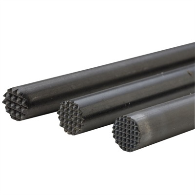

I would try these. It might take a little more time but they will be hand stippled.. Just turn something that will fit snuggly into each cap and start stippling. I have a few ideas for a jig for this if you want to pm me. Take note that these are 16 LPI, I think anything less would be too big.
Other people here might have a better idea so please keep the thread open to ideas. How many pens are you talking? What style?
http://www.brownells.com/1/1/20275-wood-stippling-punches-16-lpi-stippling-punch-brownells.html
