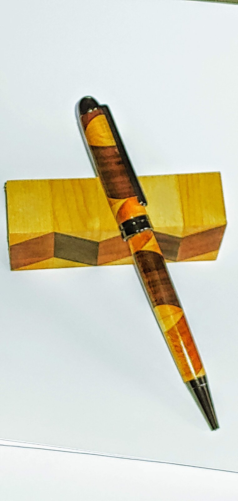

Here is my newest attempt at segmenting. It is a Designer kit with gun metal finish from Woodturningz, the woods are cherry, maple and walnut, the finish is CA. I tried a new procedure for the finish: 4 coats of thin and 3 of medium. The finish came out very well and I'm impressed with how much better it is than others I've done. I don't like how the lower blank does not match up to the center band, so the next one I make will fit to the center band on the lower blank.
