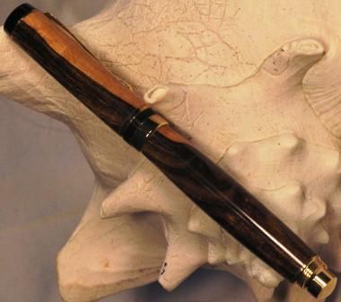

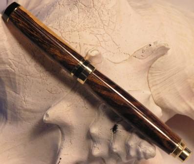

Just finished this one it is a Desert Ironwood Flat Top American with the plexi finish. There is just a slight haze in a couple of spots but still looks pretty good.
That loosk pretty sweet! What do you think of the plexi finish? Is it hard to prepare? Is it hard to apply? How long does it need to cure?
Jim the more I use it the more I like it, the cure time is very quick I go from one end of the pen to the other by the time I put more solution on the paper towel the part that I just did is dry to touch. The solution is very easy to prepare just melt some plexi and thin to a little thinner than thick CA and apply.
