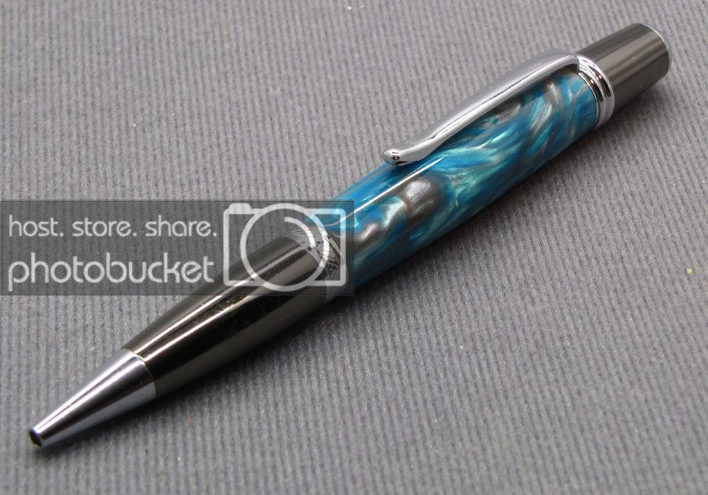

Demo pen from my video

Made a casting video and this pen is from one of the blanks.

What size PVC is that? Obviously when casting we're more worried about the ID than the OD of the pipe...and I'm not sure which diameter pipe to buy without taking a ruler/calipers into the store :)
Well, I've watched the video 2,3, and even 4 times and I like it better everytime I see it. You did a great job on the presentation and I learned alot from it. One question, if you built a mold out of a plastic cutting board, would you get any better results from it? I'm working on making me a mold.
Molds made out of cutting boards are very acceptable. I like the PVC pipe because the blank comes out round. The PVC is easy for make in quantity if I want to make many blanks. I didn't show the pressure pot but I can fit 16 blanks in my homemade holder.
I think I figure up the price on using the PVC to be less than one cent each if I use the pipe more than 5 times.
