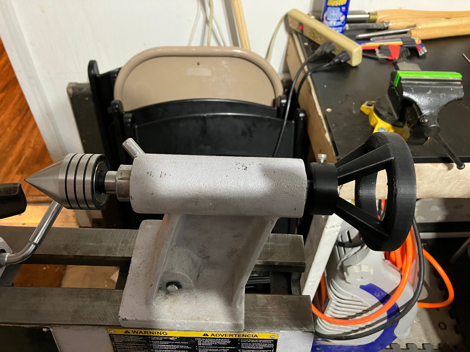

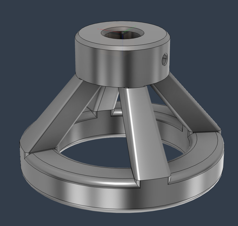

After searching high and low for a suitable hand wheel for the tailstock spindle, I just designed one to 3D print in PETG. Shouldn't have to withstand significant force, really, so hopefully this gets the job done.
The spindle diameter is 15mm (almost exactly), and the closest I could find on McMaster Carr was a 5/8" hole. Probably close enough, but then they wanted like $75 for the thing. It seems this may have been a component that Delta had custom fabricated for this specific lathe.
Possibly newer model hand wheels would be compatible. The hand wheel from the 46-460 model is still available, but they want like $100 for it. That's more than an entire replacement tailstock for that midi lathe. If this works, the total cost will be something like $2 worth of filament. Gotta save money somewhere :D Besides, I'm not even sure whether the 46-460 tailstock spindle/lead screw is even the same dimensions as mine.
If it works well and I feel the need, I may iterate on the design to add a little handle on a bearing for faster turning.

My new tailstock hand wheel printed overnight and went on today with an M4 set screw in a brass heat-set threaded insert to hold it on the tailstock spindle. It's working great. I am going to iterate on it one more time to make a few last tweaks. It's longer than it needs to be, the diameter of the hand part is larger than strictly comfortable, and I actually do want to add a little handle on a skateboard bearing. But it's working.

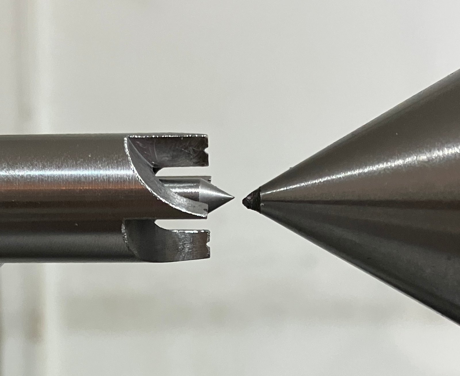

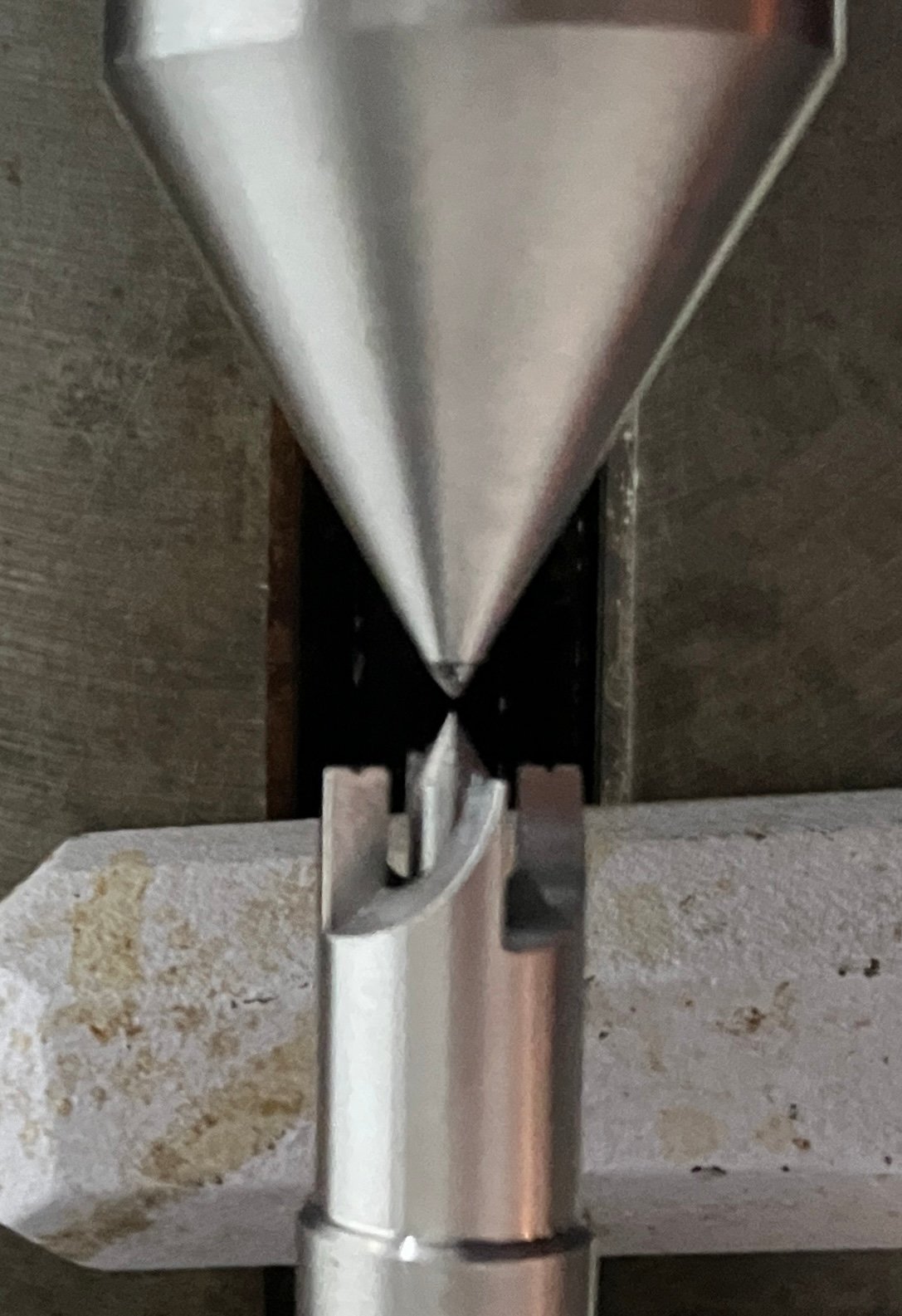

Lastly, I notice a slight difference in the headstock to tailstock alignment. Left to right is dead on, but the headstock center point is ever so slightly higher than the tailstock point. Maybe half a millimeter or so. I've tried toying with the tension of the front vs rear screws that hold the headstock to the bed to see if I can lower it, but no dice. I'm not sure it's enough of a difference to stress about. This evening I'm planning on turning a single-barrel pen between centers. My suspicion is that it will come out so close to perfectly round that I can't tell the difference. But if anyone has tips for a fix (shim the rear of the headstock? I have some very thin brass shim stock), I'm all ears.
Andrew, I recommend against trying to adjust the headstock mounting screws for this purpose.
You say front vs. rear, I assume you mean front near the spindle and rear near the hand wheel. If you change these, ie., raise the back (left facing the lathe) to lower the tip of the spindle, you will be tipping the axis of the spindle. The MOST important part of the lathe calibration is having the spindle parallel to the ways. Adjusting these screws and or shimming should only be done to accomplish this. Do you have a dial indicator and a way to hold it on the ways? Either a magnetic holder or a tool post holder? You need to check the spindle for runout close to the spindle and then farther out to make sure that the axis is parallel.
I hope this makes sense. Let me know if you have other questions.
Yeah I didn't want to leave anything loose, or mess with shimming yet. So right now I just made sure the entire bed was clean and free of debris, same with the bottom mating surface of the headstock housing where it meets the bed, and then screwed it down tightly in all 4 corners.
At this point I have no reason to suspect that the headstock is out of alignment. I'd be more inclined to suspect the tailstock. For me right now, the bottom line is whether I can turn a round pen or not. I'll know for sure the answer to that question after tonight.

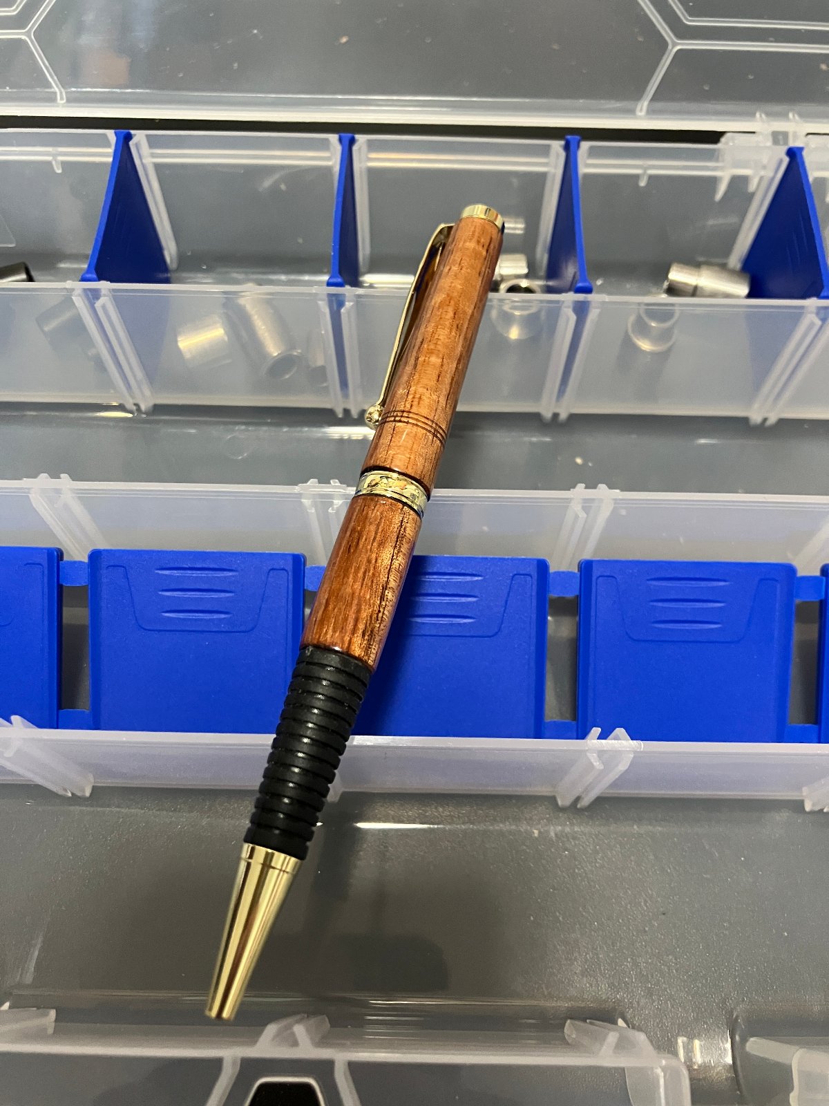

So I've done a few pens (so far coming out well, and it's been a real joy to use this lathe again). What I'm finding is a couple of things:
1. There's a bit of slop in the tailstock that lets me twist it left or right before clamping down, and it will stay where I clamp it. So being a little conscientious about making sure it's centered on the workpiece or mandrel before tightening goes a long way toward reducing vibrations.
2. The tailstock center being a bit below the headstock center is usually only true when the quill is fully or almost fully retracted into the tailstock. I think the quill is a bit damaged. Wonder if it got dropped on the concrete at some point along the line. That could explain a few dings, as well as why it was so stiff in the hole before I deep cleaned and did a bit of filing of raised bits near the key. At any rate, extending the quill a couple of centimeteres seems to largely eliminate the vertical misalignment with the headstock. I probably will want to replace this quill at some point if I can get my hands on a compatible one.
3. The dead center I bought is garbage. It makes it look like the headstock is out of alignment. When I use the (apparently nicer) spur center, it looks perfect when spinning at any speed.
4. Seating things really firmly in the morse taper at both ends makes a noticeable difference in concentricity and alignment. I may 3D print one of those MT2 cleaning tools from plastic to make sure I don't have debris in either of the tapers.
5. Using a set of pen blank jaws on my Nova chuck and the drill chuck in the tailstock, I was able to drill pen blanks that came out flawlessly. Better centering in the exit hole than I ever got with a drill press. No wandering or cone-shaped holes. Between that result and my pens showing no evidence of being out of round, I think I'm in good shape, and probably won't worry about shimming anything right now.
