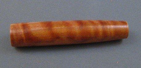

Here's what one of my blanks looks like right after I've finished applying the CA.
