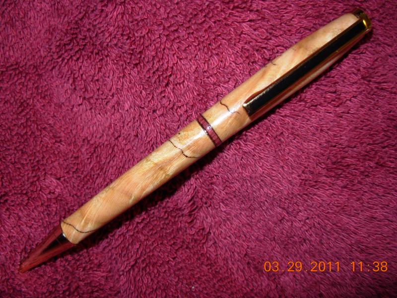

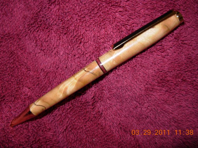

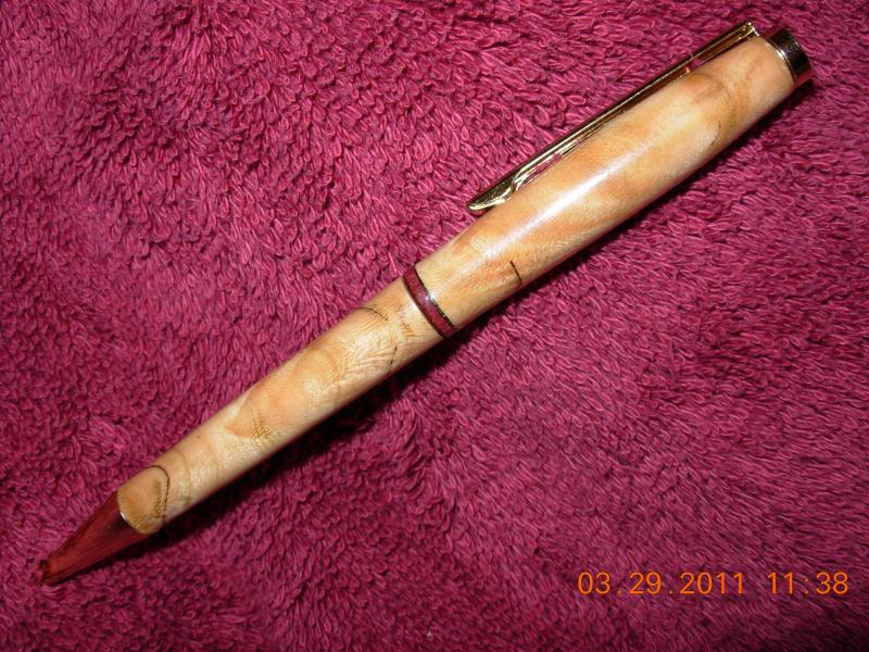

This pen was done pretty much that way exactly. The only difference was that I first taped off the Purpleheart center-band, and sprayed it with Helmsman polyurethane to give it a UV protection. Then took the tape off and sprayed repeated coats with Deft, and let it cure for about a week or so.
It might be somewhat primitive, but I was very happy with the results.
ETA: Should have included the last pic.
