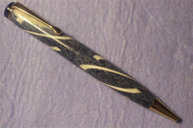

I do make pens out of antler that has sat in the leaves over a year, some of the prettiest pens I have ever made.
These two were from a humongous section of mule feer stabilzed with CA.
The the antler was around 1&1/2 " in diameter and entirely porous material.I actually cut "good parts off the outside"the part I used was the part that most would think unuesable.
I don't let anything go to waste.
