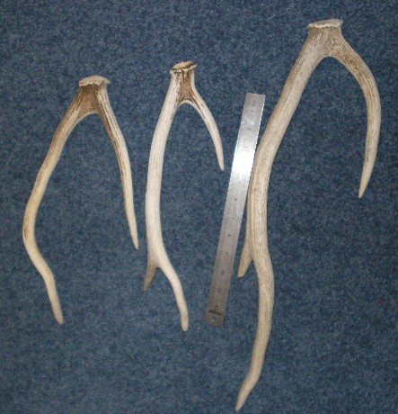

Hello just thought i would ask some advice. a friend of mine who is an avid deer hunter gave me some antler when i asked for it for pen turning. I have yet to turn any pens even though i have bought the mandrel and a heap of slim line kits. I am thinking a slim line might not be the best choice of kit and i am looking for recommendations. also some advice on finishing it. regards Allan.
P.s. do you think ill get a few pens from these? the are from sheds not kills. i had heard that they were better?

That is axis deer antler, which is fantastic for turning!! It has very little marrow space and can look like ivory when finished.
Keep that friend!! Make him a pen and keep him looking for more antler.
DOnt's waste these on slimlines unless you have a good source and can get more.
Finish with a CA slurry to fill in any small surface imperfections. Also, there's a rather large vein that can sometimes cause problems. FIll with crushed turquoise or other material if needed.

I figured you were from Australia because the antlers were upside down. [;)] Those are good looking axis antlers. Just be prepared for the stench when you're cutting and turning. A respirator/mask and good ventilation are musts.

Axis antler does not have the large marrow space (vein) that whitetail antler does. This is what makes it so great for turning.
reply very funny about the picture being upside down. i actually took it sideways and when i posted it that was the way it lobbed onto the site lol. Great to here that they could be the better of the more common antler around :)
Not the marrow vein, but actually a hole that runs throughout. The vein can be exposed depending on how you drill. I've tried cutting axis in half to get 2 pieces for slims/comforts, etc.
Anyway, this is still some great antler to use.

if you want to make a slimline, use some of the smaller pieces/ends. Price according to scarcity. Can be slightly tricky to drill due to curves. Cut off a slight bit more than usual to ensure the blank will be long enough. IMHO
