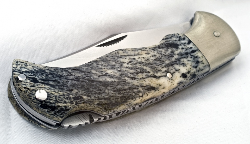

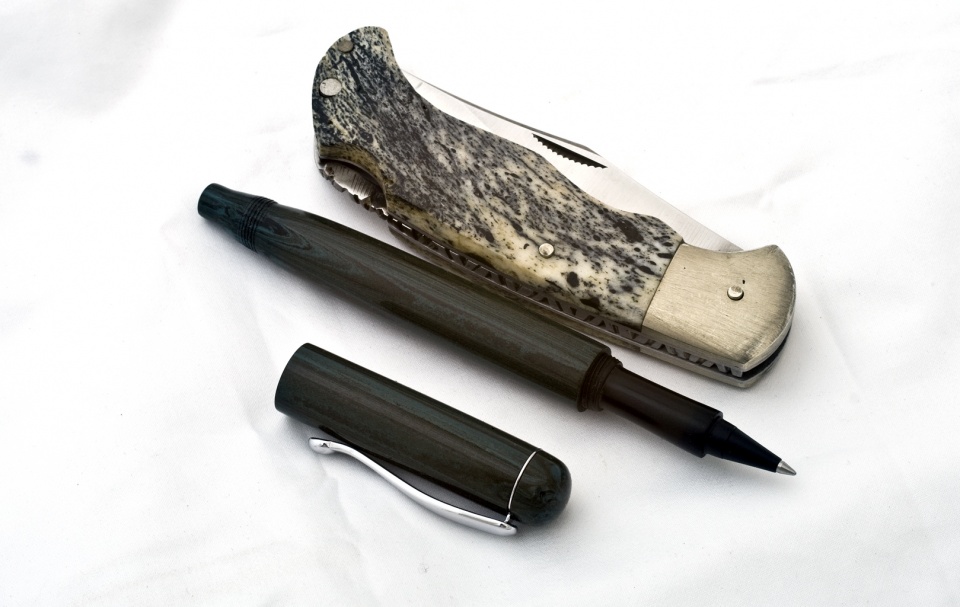

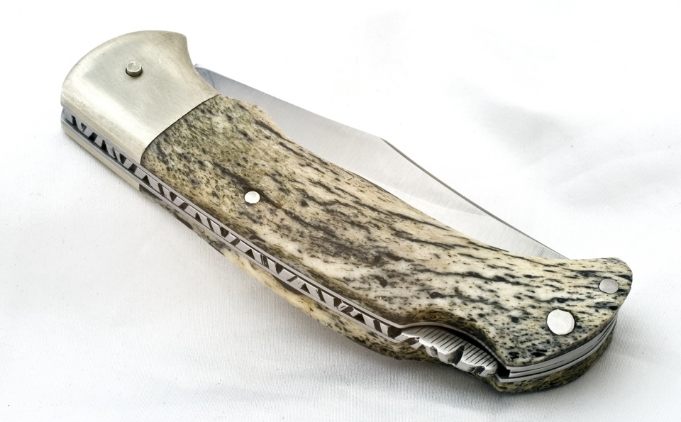

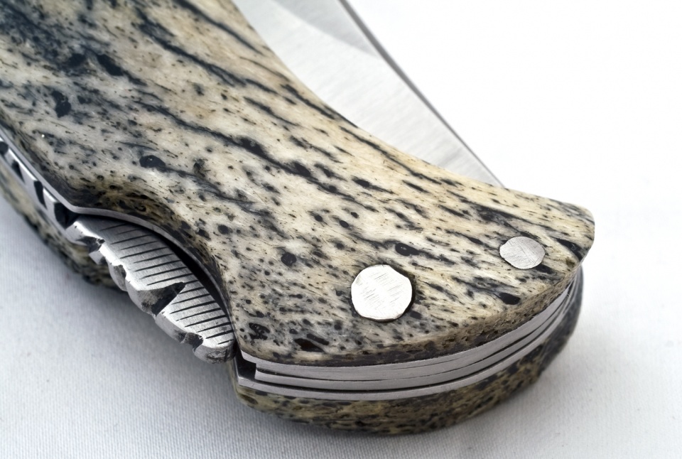

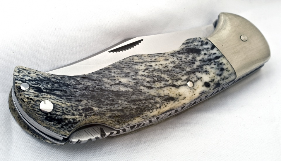

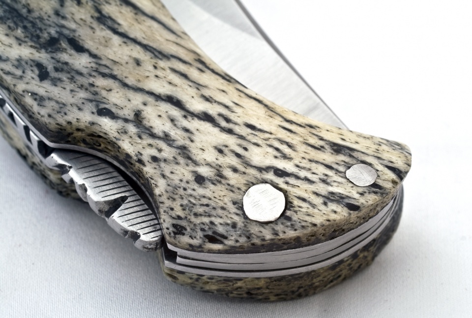

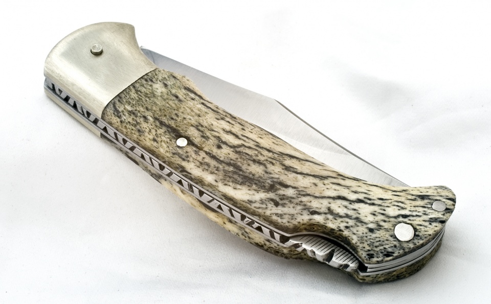

I just got back from a very relaxing weekend and first up on my plate is to finish this knife for Jyreene. Tonight I finished the spring pins and the lock pin. Up next is some rough clean up profile on the spring area, then the lock bar cleanup, then peen the pivot pin and profile everything real good and clean up the liner edges and sharpen it.
This is some teaser shots of current progress.
attachment.php
The uneven metal you see on the bottom here will get cleaned up once it's all together as things will drastically shift. Once all the pins are in place and locked down then can I do final detail profile shaping. Right now it's a rough outline.
attachment.php
attachment.php
The filework on the lock bar is not the greatest but I attempted to make it look non-uniform like something antique old and rustic. After all it is some very specialized stabilized elk antler.
Right now the lock bar and the blade can be easily removed for work in whatever area is needed.

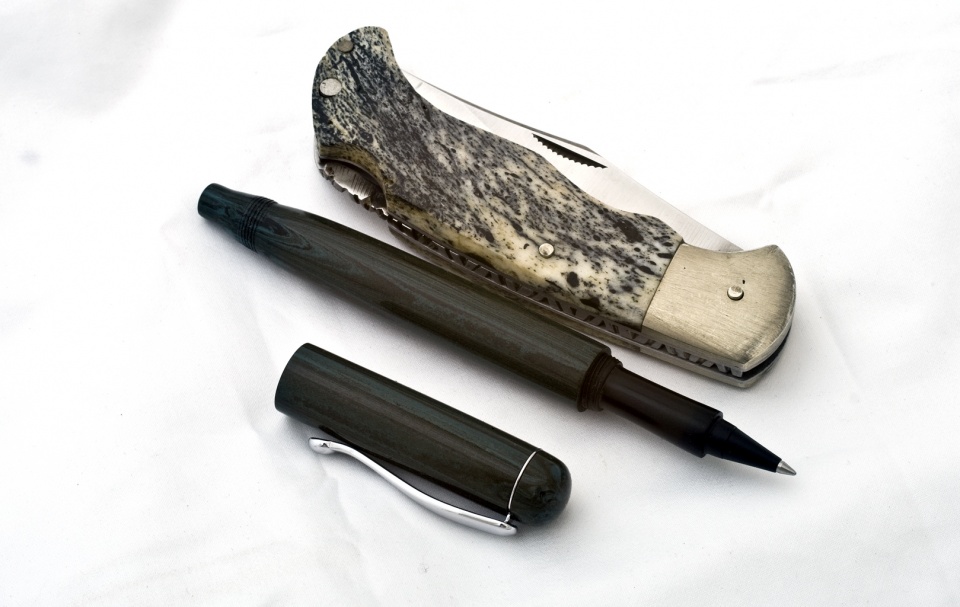

As for the pen goes, it's all done, going to shorten it by about 1/2" on the lower barrel because I dislike the length of it as it is currently.
