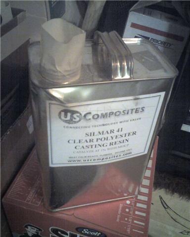

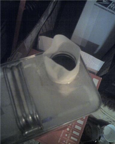

I have gone thru several gallons of PR with this cheap spout made from 2 inch masking tape. I cut a piece about 4-5 inches and wrap it around the mouth of the gallon. Just gotto make sure the tape is nice and tight on the mouth of the gallon. The residual PR runs down the spout and back into the can. When done just remove tape and wipe off small amount on mouth.
Before this "spout" I would always have a mess with the gallon metal canisters.......
