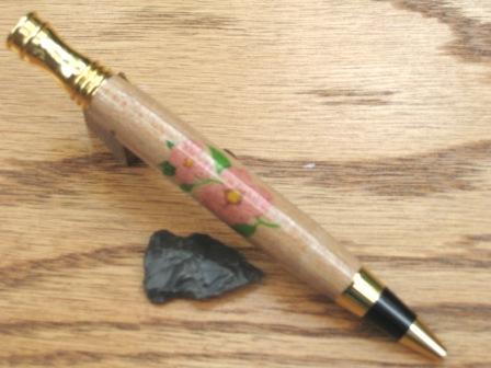

Dave,The ones I have done I did not rough up the finish for the application of the decal. I put 4 coats of ca finish on the pen then applied the decal with water(just like the old model car decals) let the decal dry for 24 hrs. then applied my final ca finish. I`m certainly not a pro but maybe this will help if the pros don`t respond. Good luck. This is a poor photo of one that I did.
