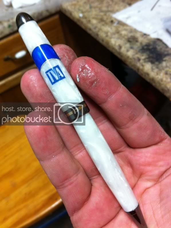

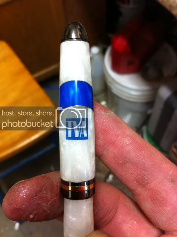

here is one I just finished on acrylic. I will agree there has to be some moisture somewhere.
