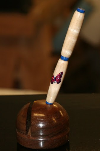

This is on wood, and it isn't a decal...it is just one of those "laser stickers" that is sort of holographic. I put on 3 coats of CA/BLO, then wiped it down with a little DNA to remove any traces of BLO. I stuck on the sticker and applied a coat of thin CA, and misted it lightly with accelerator. Then I put on more coats of CA/BLO until I could no longer feel the raised sticker. They are pretty thick stickers so it took about 12 coats of medium CA/BLO.
Turned out nice though. This is on curly maple. I also did a rose on Lauan.

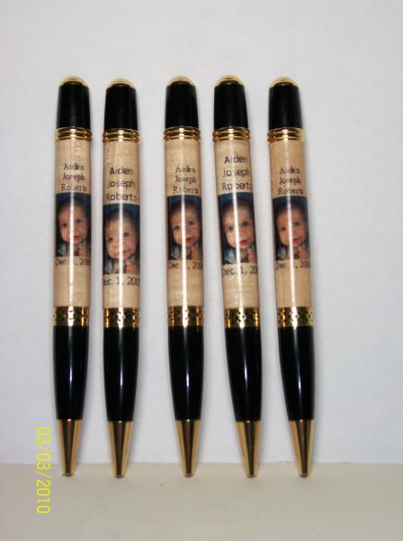

Thats about how I do it too. My first Grandchild.

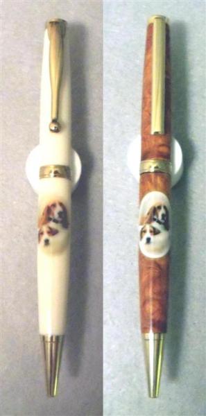

--- be also advised that there are also two types of ink jet decal paper, (also available in the laser paper) Clear and White. The White decal paper is generally used where there is a dark background that may hide the details of the decal picture. The Clear decal paper is used generally on light colored materials that will not interfere with the decal picture detail.
I've attached a picture of two decal pens, one using the Clear decal paper, and one using the White decal paper. I know the picture is not the greatest, however, for demonstration I think you can see the difference.
