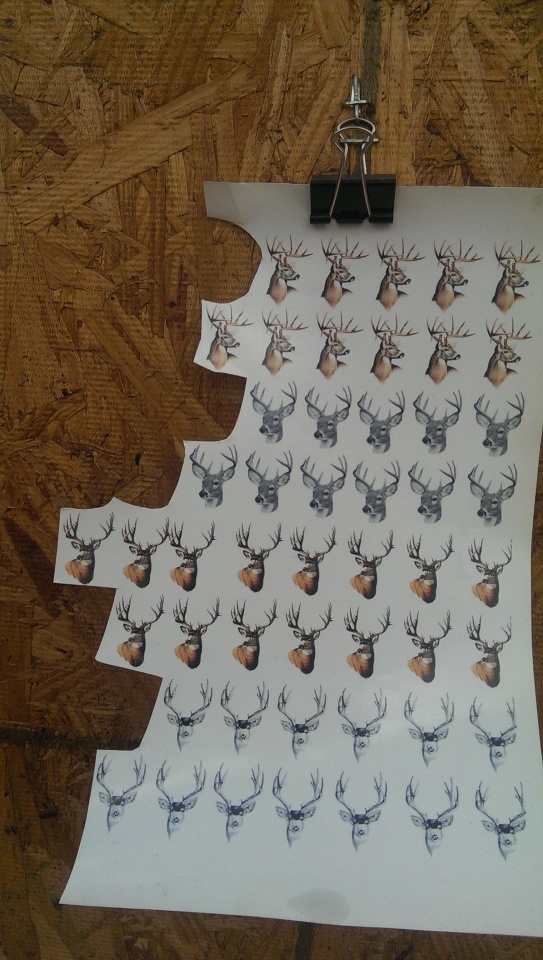

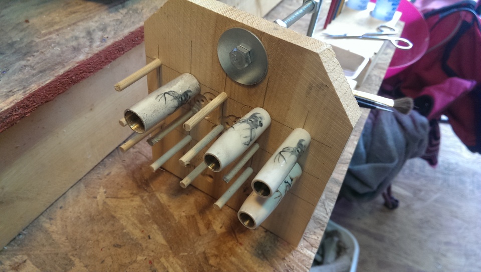

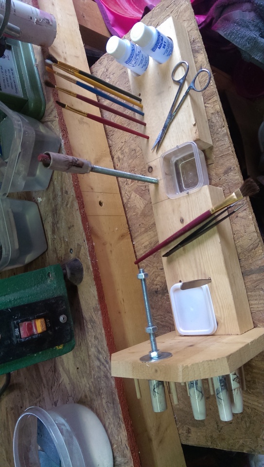

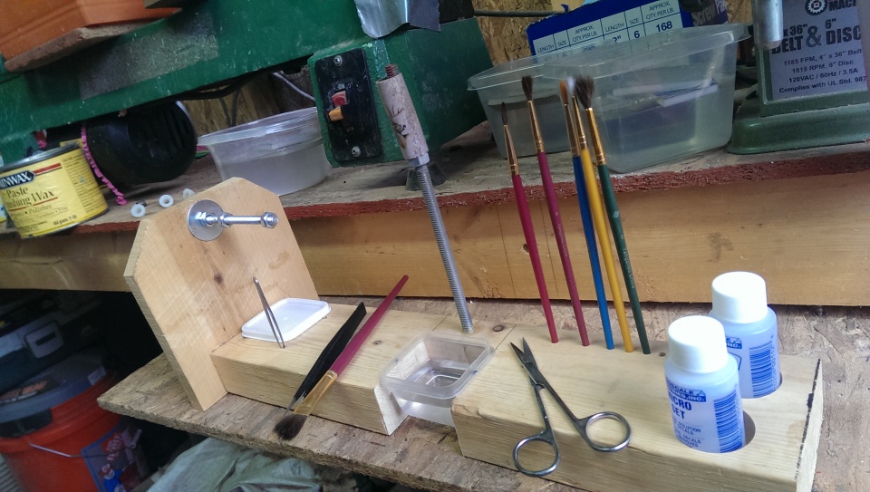

This is a little quick set up I made to help me apply decals. The bolts help hold and position the blanks, The micro set solution is a must and then a drying rack on the back. Works pretty good. Anyone else use something like this? would love to see it. or any good tips !!

mostly do decals on antler, turn the antler, sand to 400, 8 coats of med CA, sand to 800, wet sand with mm all grits, print waterslide decals, seal decals with gloss clear coat,apply micro set to blank, soak decal, apply decal. another coat of micro set, let dry then apply 8 coats med CA,sand to 800 then wet sand with all grits of mm.
I like it Rodney. I don't do a lot of decals so I just do them on the lathe. Never heard of micro set solution. What is it and where do you get it? Also what kind of decal paper are you using?
Clear
What do you use for the clear coat on the decal? Anything special? What type of printer do you need? All I have is an inkjet.
What are you printing the decals on?
Would it be possible for some of us to order just the decals in small selection packages from you?
