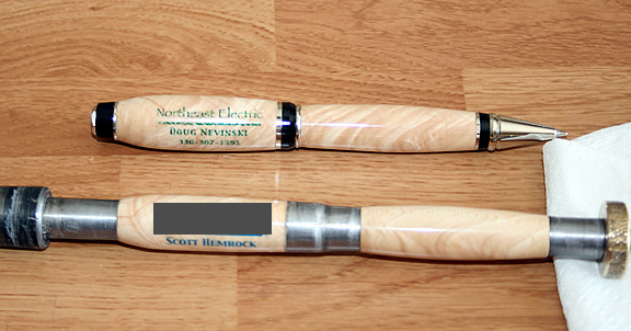

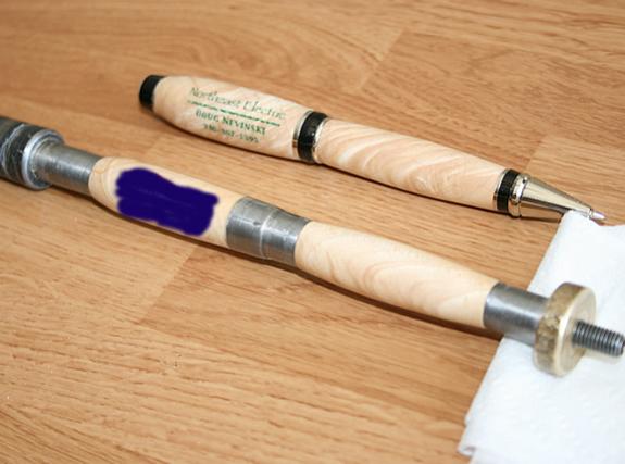

I have been working on some advertisement pens for friends recently. I had a few people ask me how I make my pens with decals so I figured I would make another video to demo to process. I also show how I turn my pens completely in the video making these two pens.
First of all, thanks to Grizz for introducing me to testors decals. Before that I was using avery brand labels and being very creative. Testors works so much better.
Both pens are made from curly maple.

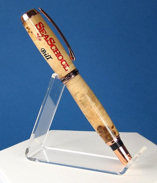

I have been making decal pens for a long time now... and the only way I know to hide the edge perfectly is to apply a tiny bead of CA (I use medium) around the decal and let it dry. It will be proud of the surface and need to be sanded down. Then another bead around where the previous bead was and repeat. Same idea behind drywall taping... a layer around the tape, then a wider one, then a wider one... then finish the entire pen. Comes out good that way.
I use a coat of ca to seal the wood prior to the decal or the wood will draw out the water. If I let it dry 12-24 hours it sticks pretty good. I also use medium ca to seal it. While it is spinning I drop the ca on the tube and spread it with my finger in a rubber glove.

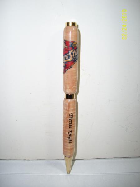

Like Grizz and the Chief said, I can't see my decals at all. A coat or two under to seal the wood, then I put a "bead" or two around the edges if I need to, then coat the entire pen X number of times, sanding with 1800 MM between coats just to make sure if sticks.
