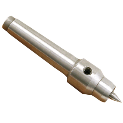

RE: drive centers, while I prefer the type that Lee pictured, the new (relatively) safety centers are also a good start. PSI sells them, as do many others. Although it looks contrary, they provide good grip. Their best feature is that catches are less likely to cause UFOs (undesireable flying objects).
