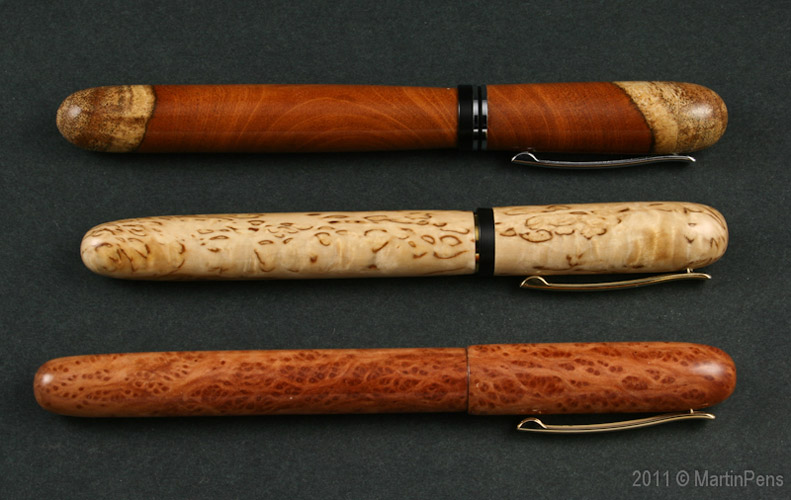

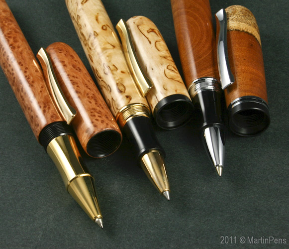

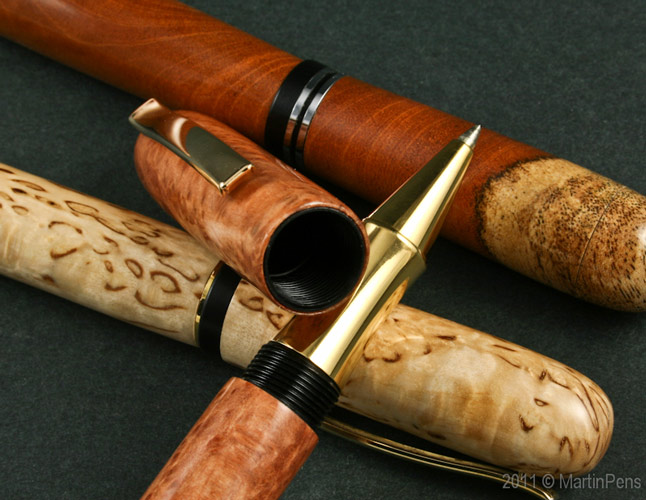

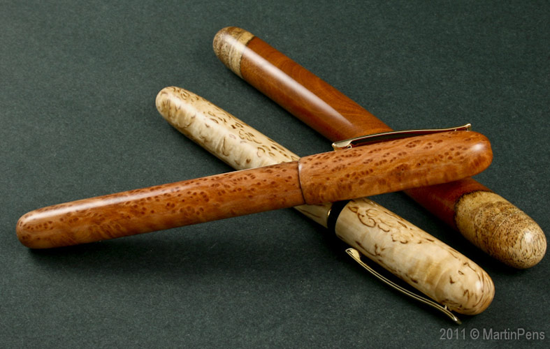

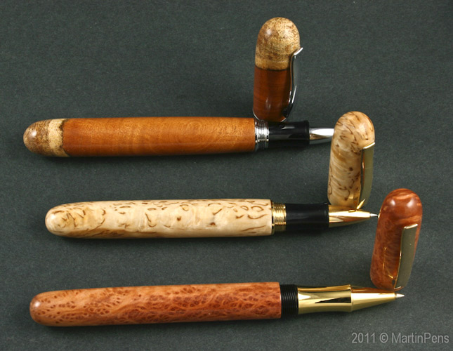

Recently I have been figuring out how to recess hardware and maximize an all wood pen view without going kitless (yet).
Here is a progression as the black ring is eliminated.
I have a tutorial on the process in the 2011 Library that explains the process.
First photo - Pen at top is Cuban Mohogany on sterling silver Churchill kit. Cap end was cut for clip insertion.
Pen in the middle- Masur Birch with Churchill kit - black ring looks nice on this pen. Clip is hidden.
Pen at bottom - Redwood Lace Burl with mixture of Gentlmen's kit and Churchill tubes. (see Library article) with hidden clip and recessed parts.
Comments welcome.
Martin

Those look great Martin! I'm excited to see the tutorial, thanks for putting in the time to figure out how to do this, and for being willing to document it and share your process with the rest of us.
Thanks Charles. I have been inspired by others here and I hope others can get something out of this. It's a great cycle and is what makes this such a great forum.
Martin
