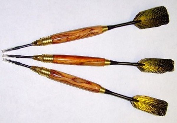

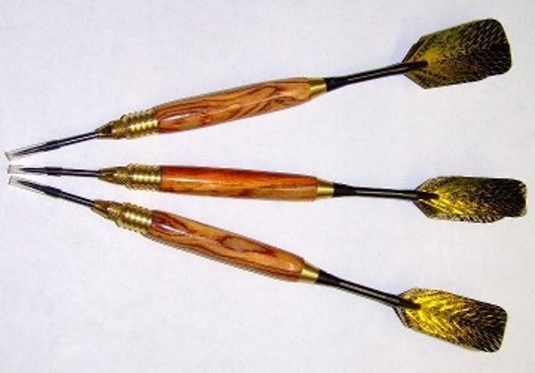

Here's a pic of a set I made out of corian.
The kit comes with some lead wool for weighting the darts. I made a set out of antler for my brother-in-law, and had to stick a bullet inside the tube to get the weight up to 19g.
You'll notice that I swapped the nose and tail pieces. Every darts player I showed them to preferred them this way.

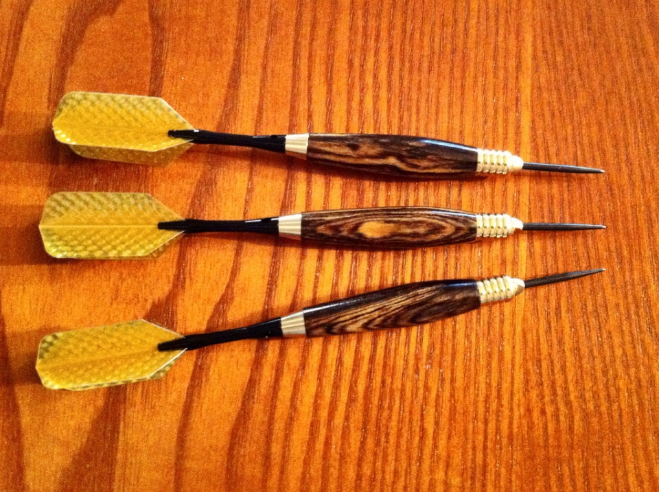

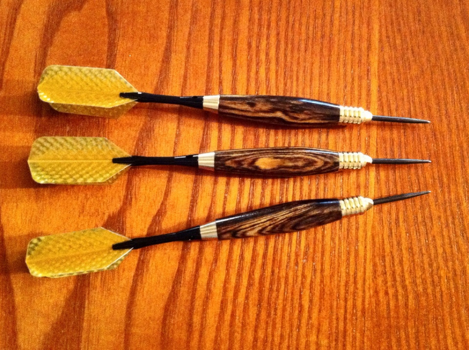

I have attached a photo of a set that I turned with Bocote.
I had no problem bringing them up to the weight I wanted by tamping the lead wool tight with a just right sized drill bit tail first.
I was able to get them to 23 grams without the shaft and flight with room to spare.

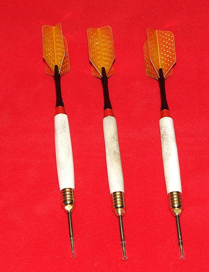

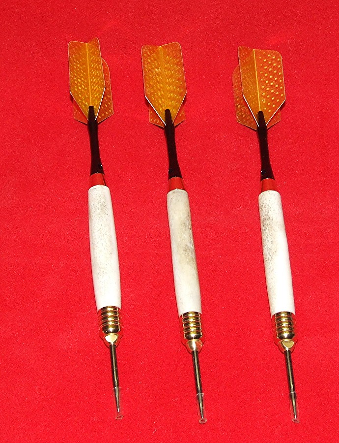

I've done several sets... I like to do them from deer antler... usually get about $100 for a set of 3... all of mine have been the steel tips.
You'll also want to get the gram scale so you can weight them equally...
