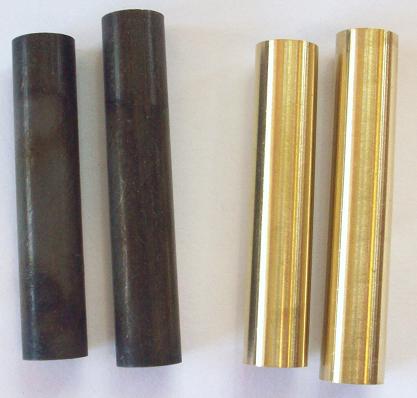

I stumbled onto this a couple years back by mistake but it finally serves a purpose. Ive been painting my brass tubes when casting and glueing up acrylics, but have had a few problems with paint rubbing off when inserting into the drilled hole and leaving brass shine in the blank. I remembered back when I was trying to clean out a piece of brass that had gotten cloggeds, with some liquid drano. The result was dark brass. I just finished a bucket of tubes and thought i would post the before and after. I sand and rough up the tubes first and then stand them up on end in the bottom of a small bucket. I pour in liquid drano just over the top of the tubes and let sit over night. The next day I rinse and dry and they're ready to go. One thing, drano will bubble up and out of the bucket if its not very tall, so put down a drop cloth.

Mike (MLK Woodworking) sells a product called Brass Ager that works in 5 minutes and is not as caustic as Drano. I believe the main ingridient is muriatic acid which I used to use as soldering flux. It won't burn you and you just rinse it off with water if you get any on you.
"Muriatic acid" is just another name for hydrochloric acid. Drano used to be sodium hydroxide, but I don't know what they put in it now. Both hydrochloric acid and sodium hydroxide solutions can be very nasty to handle if the concentration is high enough. Even at a low concentration, I wouldn't want to get any in my eyes.
Both, however, are water soluable. Give the tubes (and your hands) a thorough rinsing afterwards and you should be fine.

I'll have to check on the brass ager and blackit for next time. Drano works well but doesnt last as long as the other stuff (im guessing). thanks
