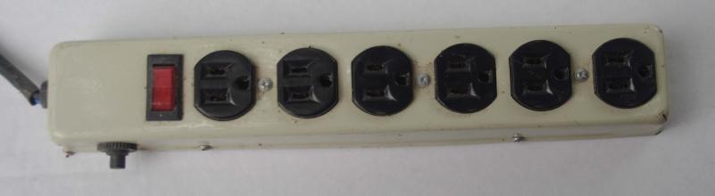

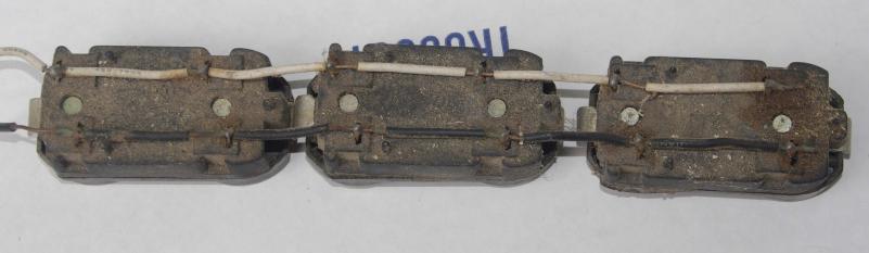

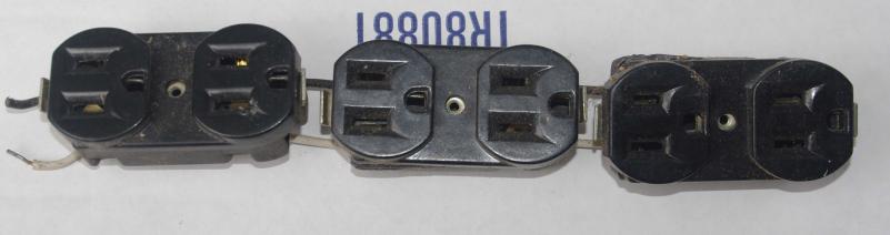

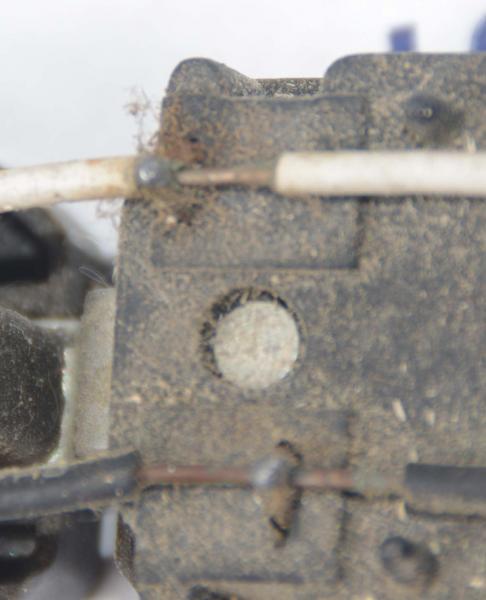

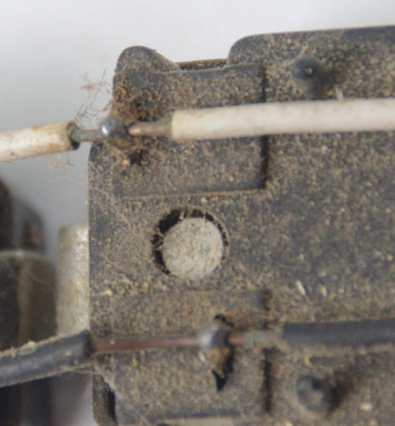

I needed some receptacle the other day and, in my infinite wisdom and cheap skate fashion, decided to re-purpose an old outlet strip I had lying around. The first photo is of a similar unit. The second one is the face of the strip of receptacles removed from the case. Third is the back side where I found the problem and the next two show the same solder joint with no connection from the receptacle to the wire. Look closely and you can see where the wire just slides along the wire. You may also note looking at the back photo of the strip, there is no ground wire run. This device depended on the center screw to provide the grounding connection and provide the sole support of the receptacle, neither of which is legal.
OK, my fault partially as I did not check and verify this outlet strip was UL approved, which it very obviously, was not. Never-the-less, just PLEASE be aware that there are electrical devices on the market that will burn your house down and possibly even kill yourself and/or your loved ones.
